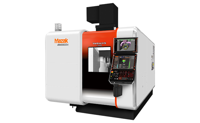

5-axis Machining Centers
VARIAXIS i
- Multi-face machining and simultaneous 5-axis machining with one chucking
- Wide variety of table sizes, spindles, and automation systems
- Turning capability for further process integration (i-700T, i-800T, i-1050T)
Machining from raw material to final product in just one machine
Higher productivity with process integration by turning and milling
- Reduction of setup process
- Significant reduction in production lead time
- Reduction of fixture and equipment costs
- Reduction of machine installation space
- Minimization of cumulative errors by process integration to ensure high accuracy
High-rigidity for long-term high-accuracy machining
Full gantry construction without overhang
Machine construction was designed utilizing FEM analysis. Vibration is minimized during acceleration / deacceleration to ensure high accuracy machining stability. (Note: The construction of VARIAXIS i-500 is different.)
Built-in motor spindle
Built-in motor minimizes vibration during high speed operation. For high accuracy machining, temperature controlled cooling oil is circulated around the spindle bearings and headstock to minimize any thermal change to the spindle.
High-accuracy 5-axis calibration MAZA-CHECK
Position misalignment and incline of the rotary axes can automatically be measured and compensated to realize high accuracy 5-axis machining. The centers of rotation of both the C- and A-axis can be automatically measured and compensated.
