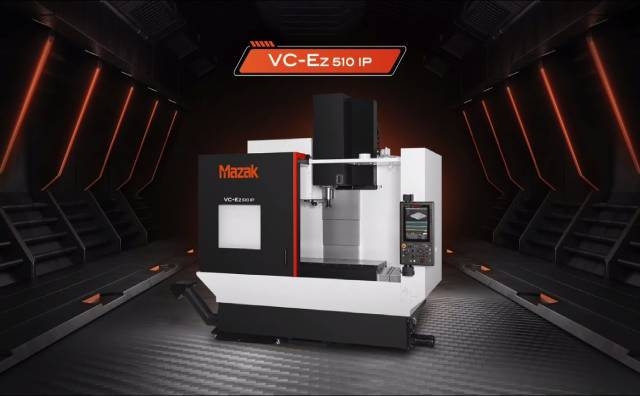

Vertical Machining Centers
VC-Ez IP
- Powerful, high-torque spindle for higher productivity
- Largest table and machining area in its class
- Designed for stable, high accuracy machining
- MAZATROL SmoothEz: CNC system for unsurpassed usability and high productivity

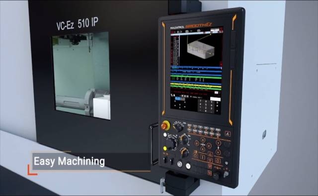

MAZATROL SmoothEz
Equipped with "QUICK MAZATROL", an improved version of MAZATROL programming. Programs can be made intuitively with the 15" touch screen while checking the workpiece shape and work process. If combined with the SmoothCAM Ai software (separately sold), machines in your factory can be replicated on your office PC, allowing digital setup of your machine to improve operational efficiency.
