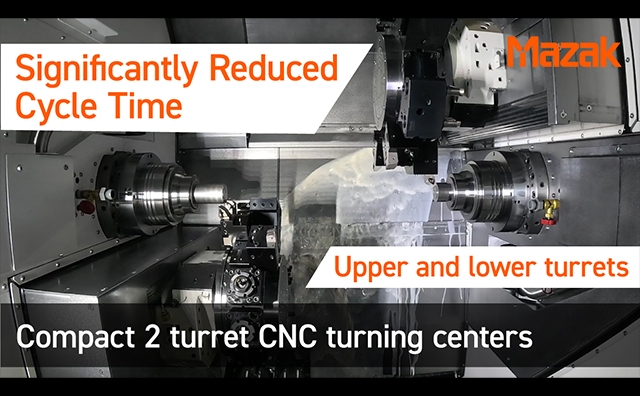

Compact 2 turret CNC turning centers
  • Upper and lower turrets enable significant reduction in cycle time
  • Easy programing of balance cutting and simultaneous left and right machining with the conversational MAZATROL program
  • A wide range of automation options to enhance productivity, including bar feeders, workpiece unloaders, and automatic parts catcher
QRX-50 SG, QRX-50MY SG
(Tailstock spec.)
Simultaneous machining with upper and lower turrets enables efficient mass-production machining of shaft shapes.
QRX-50MS SG, QRX-50MSY SG
(Second spindle spec.)
The 2 turret and 2 spindle machine construction allows simultaneous left and right hand machining, enabling efficient mass-production machining of bar shapes.
