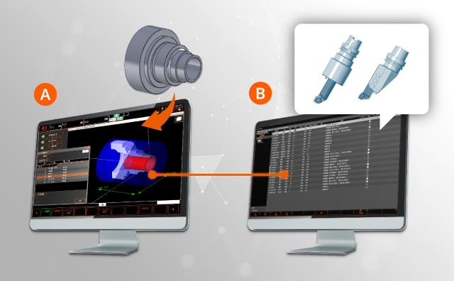

TOOL LIBRARY
Tool information used on machines is centrally managed. By registering not only magazine-mounted tools but also tools on the tool shelf, along with the projection length, cutting conditions, and preferred tools, SOLID MAZATROL allows you to select the optimal tool. Registered tool information can be transferred to machine data.
  • A: |SOLID MAZATROL
    MAZATROL programs are automatically generated from 3D models.
    An optimal tool is automatically selected by referencing the tool library.
  • B: |TOOL LIBRARY
    Detailed tool information database.
    By registering your owned tools, tool selection becomes smoother.
