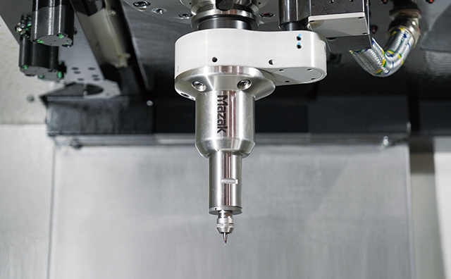

Ultraspindle*
Electric motor spindle for high precision finishing
Two types of high-speed rotation are available; 60000 min-1 and 80000 min-1. It is suitable for surface finishing, micromachining, drilling, and mirror-finished machining, achieving excellent surface quality and high-precision. The ATC-enabled structure allows for rough machining, semi-finishing, and even super-finishing to be performed consecutively. It is highly effective when high-precision finishing using small diameter tools is required, such as for metal mold and semiconductor manufacturing equipment parts.
*Compatible models: VCN-460, VCN-600
60000 min-1 / 80000 min-1
- A single machine integrates all processes from rough machining to finishing
- No special program is required, and machining is performed with the same program as for regular tools
- The ATC-compatible compact spindle eliminates the need for operator intervention for setup changes before and after machining.
