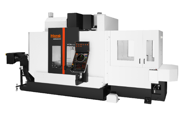

Spindle rigidity and best balance of rigid machine structure
3D design with structural analysis
Using CAD FEA, the main machine components such as the bed and column are designed to minimize distortion. Compared to the conventional model, distortion on the column caused by heat displacement has been improved by 40%.
The low-vibration, high-performance spindle reduces thermal expansion by adopting outer cylinder cooling with machine temperature synchronization. Stable machining accuracy can be obtained.
* VCN-460
* Photo shows VCN-460.
VCN structure
