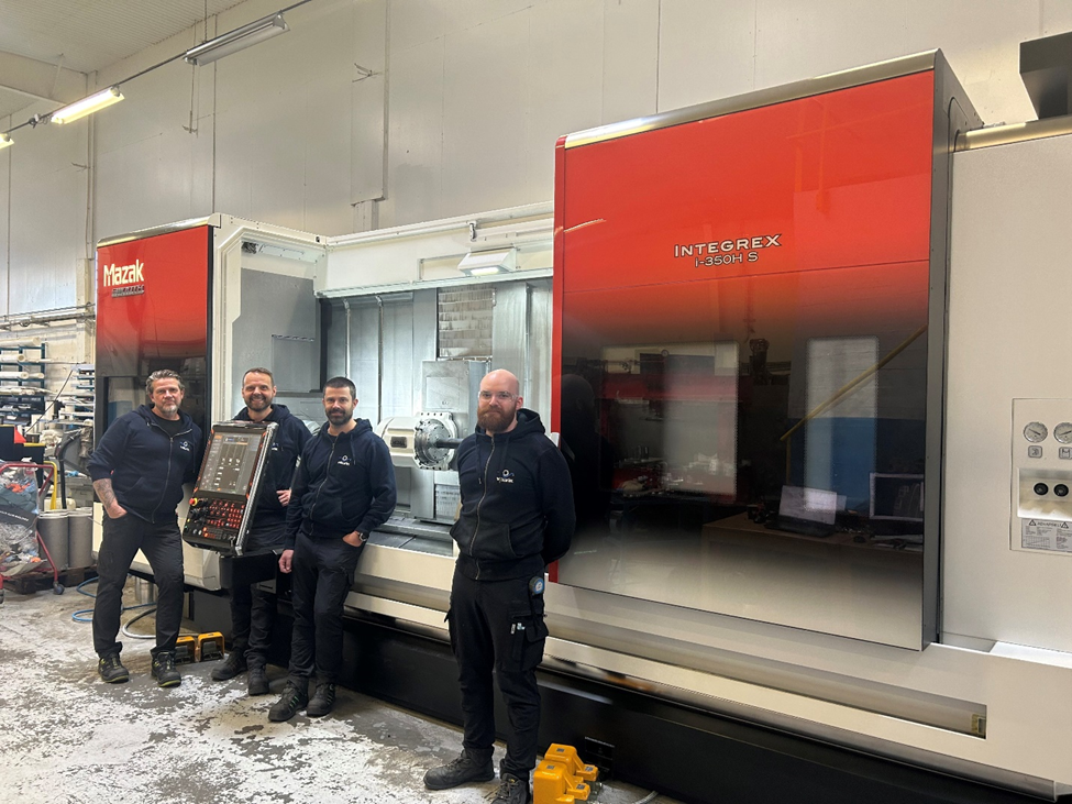

"In the past, the product required multiple machines with multiple setups, with the new INTEGREX i-350H S we have the possibility to do all the machining DONE-IN-ONE” Daniel Gudmundsson (Director / Vélvik EHF)

The ninth Mazak machine has arrived at Vélvík EHF in Iceland. Mazak has just completed the installation of an INTEGREX i-350H S x 2500 U at Vélvík. Vélvík will machine large parts up to Ø340mm x 1000mm in aluminum on their new INTEGREX. The investment in the Mazak INTEGREX i-350H x 2500 U was chosen because the workpiece needs to be turned, drilled, and milled both externally and internally. With the Mazak INTEGREX i-350H S, the workpiece can be machined in a single "Done-in-One" operation.
From Multi-Step Processes To One Machine
The concept of optimizing process flow has become possible with the new INTEGREX, due to specialized solutions implemented on the machine. This has helped Velvik achieve more precise and flexible machining of their parts. In the past, processes required multiple operations across various machine types, such as turret turning machines, pre-cutting on 5-axis milling machines, and several final cuts on multitasking machines before the parts were completed.
With this new concept, all operations can be handled on one machine, the INTEGREX i-350HS. Initial roughing and final finishing are still necessary, but the machine and its equipment allow for simultaneous part transfer from spindle to spindle. The steady rest is specially designed to handle a swing from Ø430 down to Ø75. The INTEGREX additionally features powerful chucks with a quick-change jaw system. The integrated Superflow coolant system operates at pressures up to 70 bar in multiple pressure steps, providing flush coolant through both turning spindles.
