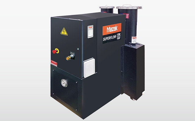

Mazak SUPERFLOW
High-pressure coolant system for higher efficiency and productivity
  • By delivering coolant at high-pressure, Mazak SUPERFLOW can deliver coolant even to tips of sharp tools that are normally inaccessible, enabling machining under a more optimal cutting condition.
  • Can efficiently remove chips and prevents tool damage.
  • Improved cutting performance by preventing the evaporation and vaporization of the coolant itself to ensure that the coolant is delivered to the tool tip and cutting surface.
  • Coolant pressure easily set by M-code.
