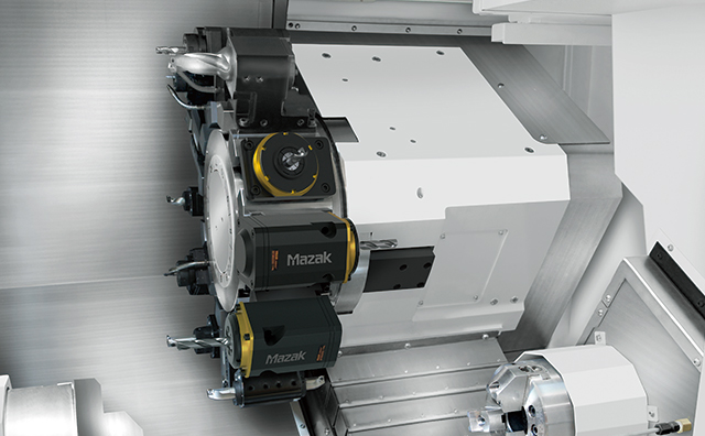

High speed drum turret with minimum interface
Three types of turrets are available for different applications
Depending on the model, 12 position drum turret, 16 position drum turret and 12 position drum turret (24 position) can be selected. Drum turret with minimum interface and non-lift rotary indexing perform high-speed clamping/unclamping. Tool holder can be selected between bolt-on or VDI.
Bolt-on turret
VDI turret
High precision, high speed spindle
An integral motor is utilized for the turret milling spindle to minimize vibration for high accuracy. The motor unit is cooled to minimize heat generated during high-speed revolution.
