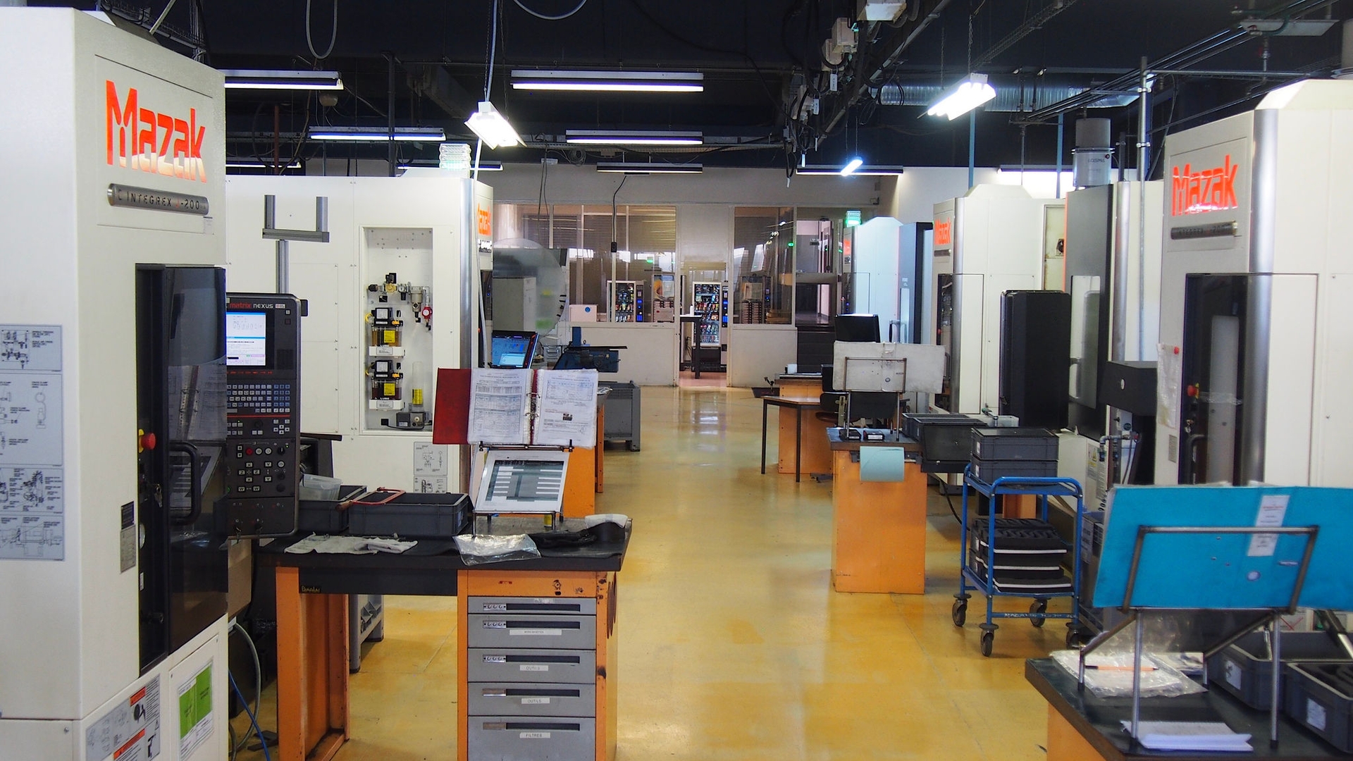

Since 2019, Groupe Lépine has been committed to a strategy of huge, systematic investment in production tools in order to respond more effectively to the growing demand for materials destined for medical use, particularly in the area of implants and ancillary equipment. To support this dynamic investment, the group has set its sights on Mazak machines for many years. “We have many Mazak machines.” Inside the plant, Allée Mazak (Mazak alley) is aptly named. “In 2012, the business invested in its first INTEGREX j-200, with two more in 2014 along with an FJV milling machine,” recalls Benjamin Amodeo, Process and Industrialisation Manager at the Orthez factory.
The workshop also has an INTEGREX j-200S machine for instrumentation parts for the KNEO range – ancillary equipment for knee implants – with a bar diameter of 65 mm and a bed length of 1,000 mm. Later, three other INTEGREX centers were installed in the plant in the 2010s to produce hip prostheses stems. These machines are fitted with an onboard control system that enables a unique Mazak application with a self-test function and automatic correction in the event that the path is broken. “These INTEGREX j-200 machines give us the levels of precision that we need, as well as turning and milling within one machine, thereby reducing the number of work steps,” said Jérémy Lannes, Process Technician. “These machines are very ergonomic and easy to work with.”

The decision was therefore made to purchase a Mazak INTEGREX i-250H S, a twin-spindle center with a 1,000‑mm bed, a bar feeder and an automatic parts conveying system. Equipped with a 74 tool magazine and cutting tool breakage detection, the machine was installed in the factory in July 2021. The spindle is tested using a Renishaw touch sensor to ensure that the precision of the femoral head machining is maximised. Also, a gripper then holds the part and transports it in a lift, placing the head in a specific tray. Alongside the machining strategy created with the cutting tools manufacturer, the huge amount of equipment and the ability to mill and turn on just one machine explain the significant increase in productivity for this femoral head production cell, with a reduction in machining time of over 50%!
