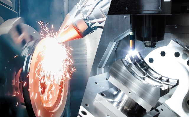

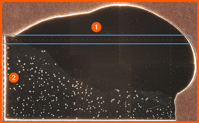

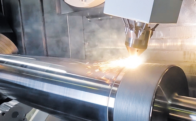

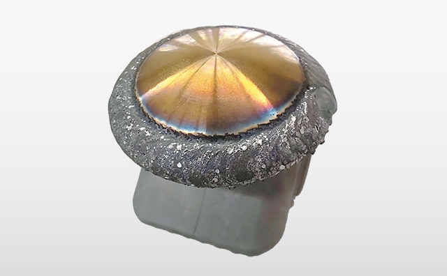

Laser metal deposition
Laser metal deposition technology is a manufacturing method that instantly melts and solidifies metal powder using a laser. It enables high-precision and dense forming, making it suitable for complex shapes, thin walls and fine structures. Furthermore, it can form corrosion-resistant, wear-resistant and heat-resistant layers with sub-millimetre thickness on the base material surface, achieving higher adhesion compared to plating or thermal spraying. It is an advanced technology that can be used to fill only the necessary parts and is effective for repairs and modifications.
1: Deposited zone 2: Dilution zone 3: Laser 4: Metal powder 5: Melt pool
Wire arc AM
Wire-arc AM technology is a fabrication method that melts and deposits metal wire through arc discharge. Compared to powder, it is easier to handle and enables stable supply at a low cost. Its high fabrication speed makes it ideal for producing large parts and performing build-up repairs. Hybrid multi-tasking machines enable machining during the layering process, allowing the shape of each layer to be refined as the build progresses. This process removes impurities and irregularities from the layered surface, significantly improving manufacturing precision. Ultimately, this results in more faithful shape reproduction and high-quality internal properties. Compared to laser metal deposition, it offers superior productivity and cost-effectiveness, making it widely used for manufacturing large components in aircraft and industrial machinery.
1: Metal wire 2: Deposited zone 3: Dilution zone 4: Assist gas 5: Arc 6: Melt pool

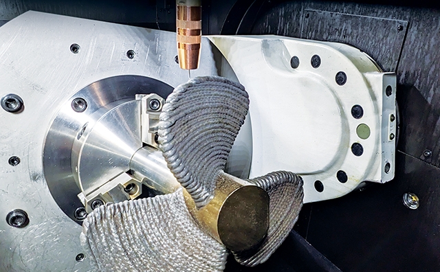

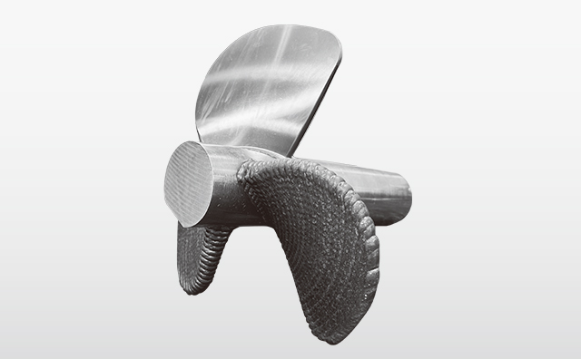

Direct additive manufacturing allows for optimised structures, such as hollow shapes and topologies which are difficult to achieve with conventional machining or casting processes. This enables new design concepts through weight reduction and functional integration.
Marine propeller

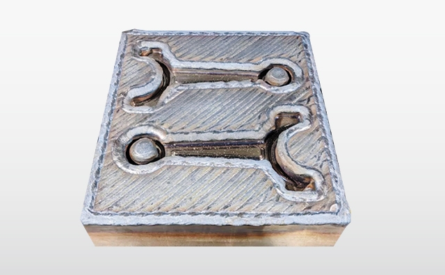

Repairing abrasion or damaged parts
By layering only the required amount of material on abrasion or damaged areas, it is possible to restore the original shape. Parts can be reused, reducing costs and making effective use of resources.
Forging mould
Crushing blade

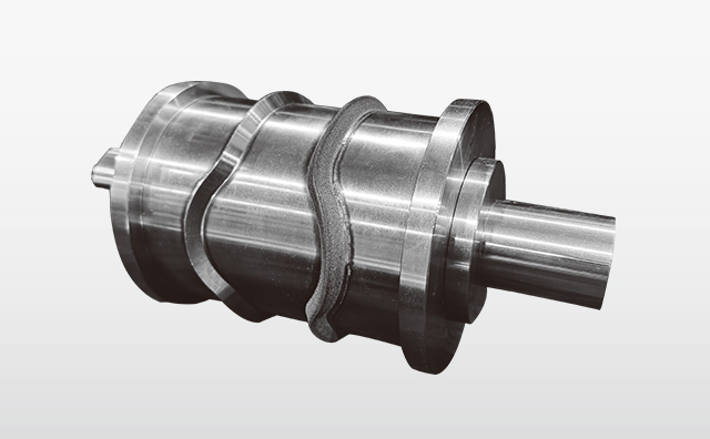

A coating that increases hardness and wear abrasion

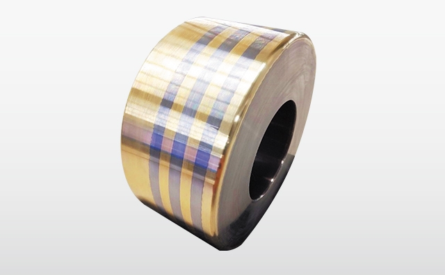

By layering high-hardness alloys or wear-abrasion materials on the surface of the base material, the lifespan of parts can be significantly extended. This is effective for parts used in harsh environments, such as tools and moulds. By controlling the laser beam diameter, it is possible to adjust the coating thickness and processing speed.
Coupling
Industrial rolls

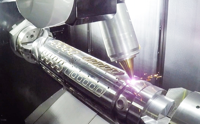

Layered deposition of dissimilar metals
By layering different metal materials, multiple properties such as wear resistance and corrosion resistance can be imparted, dramatically increasing design freedom and allowing the creation of composite material parts that were not possible with conventional methods.
Plant valves
Hydraulic pressure piston sliding part

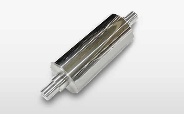

AM coating as an alternative to plating
Traditionally, plating was applied for surface hardening and wear resistance, followed by grinding for finishing. With AM, layering wear-resistant materials directly onto the surface enables plating replacement. Combined with finishing mirror grinding, it efficiently achieves highly durable and precise surface treatment.
Significantly reduce process lead time and CO2 emissions
The conventional process took 12 days, but with the introduction of the AM machine, it was shortened to 1 day.
Lead time
91% reduction
CO2 emissions from conventional processes, approximately 50 kg, reduced to approximately 30 kg with the introduction of AM machines.
CO2 emissions
40% reduction

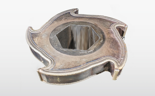

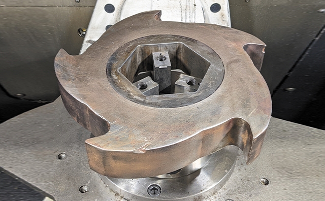

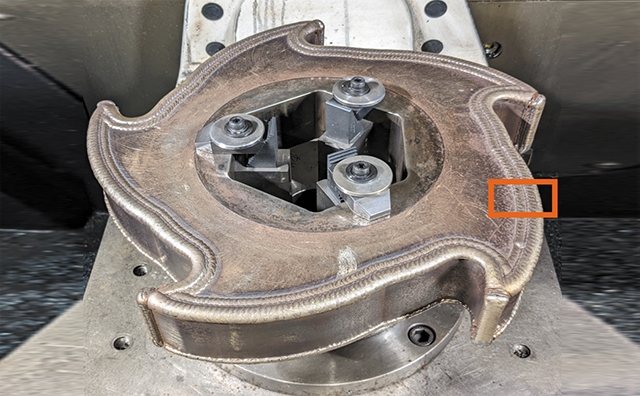

Repairing parts by wire arc AM
It solves challenges in manual repair (build-up welding, finishing) such as lengthy operations, quality inconsistencies and frequent setup changes between machining processes. It achieves repair automation as a solution to labour shortages and technology inheritance.

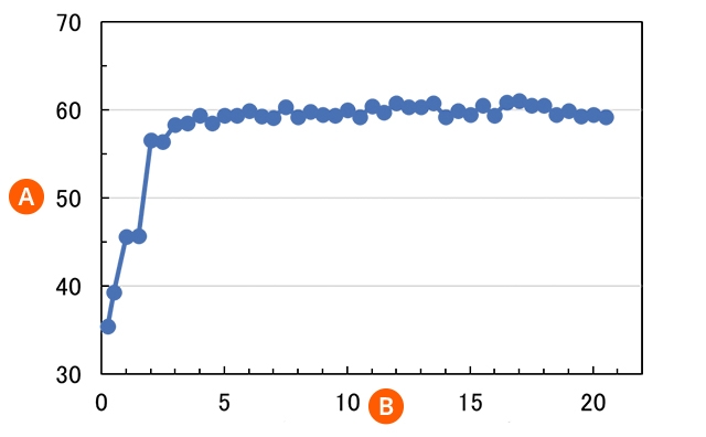

WorkpieceCrushing blade of the crusher
IndustryGeneral machinery
MaterialWear-abrasion steel
Workpiece sizeΦ500 mm × 80 mm
Hardness (equivalent to HRC60)
A: HRC
B: Distance from the end face of the test specimen (mm)
