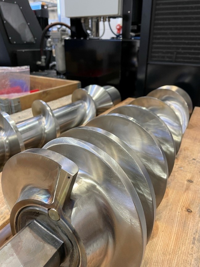

Marel produces equipment related to protein processing and for this purpose, specially developed components, such as compression housings and augers. These are constructed with very special measurements, properties and dimensions to ensure high-quality protein processing. Until now, Marel has constructed these components by hand, in the absence of better manufacturing methods.
Historically, employees had to physically lay with their arms inside compression housings in order to weld each single spline – a very difficult and time-consuming process. This naturally placed limitations on how small these components could be made, a barrier to further product development for Marel.

Due to previous time-consuming by-hand production processes, the lead-time was previously 3-4 weeks on a compression housing. Marel has managed to improve this to just 48 hours with the help of Mazak's INTEGREX i-500S. Not only has it improved the lead-time significantly, it has also improved the repeatability of the components. This means that components are now machined from one raw solid material to the finished part – as a done in one concept.

The INTEGREX i-500S is the largest member of the "INTEGREX i" series with the maximum machining capacity of φ 700mm. It is equipped with a high output, high torque, main spindle and the newly developed compact milling spindle head, which is smaller than comparable machines to provide a larger machining area. It is equipped with additional bed length for machining long complex workpieces, with the benefit of reduced interference between the turning and milling heads.
To accommodate Marel’s special requirements, a number of special options, based on the standard machine, were selected. These requirements included short changeover times, the possibility of high utilization and automatic/unmanned production of even complex items, and a quick chuck change system for both spindles.
The SteadyRest mounted with a zero-point system, makes it super simple and very quick to mount without the need for alignment, which saves time. When not needed, the SteadyRest can easily, and quickly be removed. Finally, the design of the machine includes automatic switching between large - and long-angle heads for application of inner Splines – performed with uniquely developed angle head. This also includes automatic tool change for the cutting tools in the angle heads themselves. The large tool magazine ensures that there is plenty of space for tools and sister tools, even for complex components where many tools are required. This in turn ensures the possibility of manned operation for many hours.
