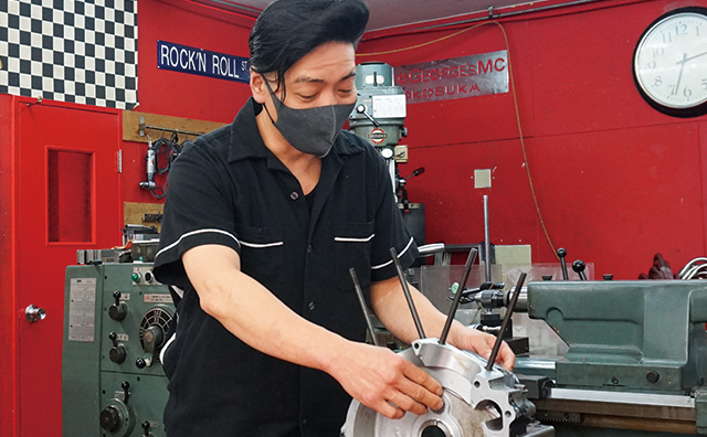

Mr. Shizuka, President, talks about the machining accuracy of the internal combustion engine
"Our specialty is regenerating the internal combustion engine. Using cutting-edge technology, we can polish old cars to a level better than when they first came out," said Mr. Shizuka, President. "We had tools, a hydraulic press machine, a TIG welding machine, an old general-purpose lathe, a drilling machine, etc. Still, I felt the limitations on analogue operation in accuracy and time as most of the regeneration of old internal combustion engines requires index machining."

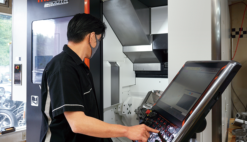

Therefore, President Shizuka looked for a machine tool that performs the entire process on-machine, from the current measurement of the workpiece to the inspection after machining.
"We were convinced that not only would production lead time be shortened, but accuracy would also be improved." In this way, they decided to introduce VARIAXIS j-500/5X in April 2021. The deciding factor was that the entire process could be done in one chucking, and that it could be linked with the NC gage.
0.0008 mm (0.00003 inch) bore tolerance realised by NC gage
The machine comes in handy for various machining, such as jig boring for the crankcase, plane cutting for the lifter block, line boring for the camshaft bearing bushing, and oil pump surface cutting. "We use it not only for parts machining, but also for manufacturing jigs for our own machines that are not available from manufacturers," said President Shizuka.
All processes are performed on the machine by VARIAXIS j-500/5X
"The most important thing is that we can avoid theprecision misalignment that occurred with the conventional method, in which machines were changed according to the process and set up one by one." President Shizuka evaluates the advantages of introducing this machine.
"The feature of  being able to incorporate NC gage on the machine was a particularly significant point of selection that other company’s products did not have. We always believed that measurement was the key to machining."
President Shizuka praises the high accuracy achieved by the NC gage linkage: "We were able to achieve a bore tolerance of 0.0008 mm (0.00003 inch) after boring, which was barely 5 microns (0.005 mm/0.0002 inch) before, even with best efforts."

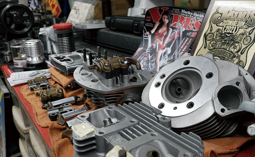

A variety of parts lined up on the counter
