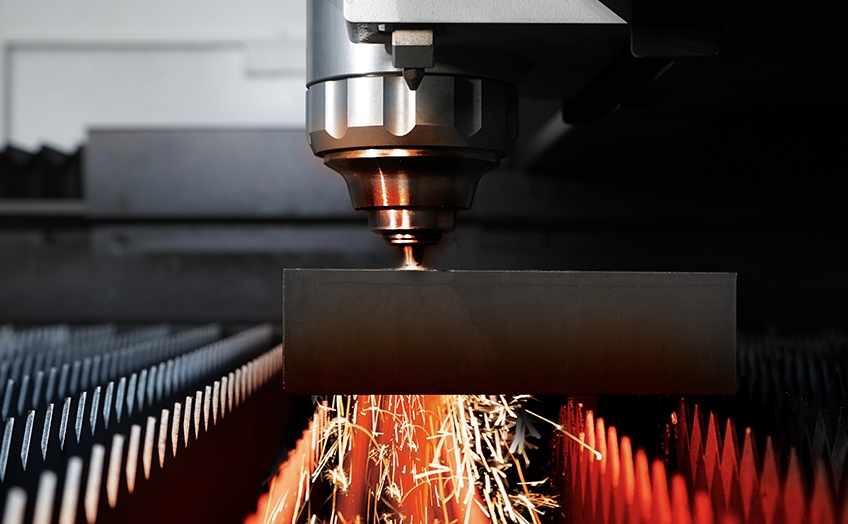

Achieves high-speed and high-quality processing
Mazak SmoothCUT and GRAND CUT raise the temperature of the molten iron while cutting to improve quality of the cut surface. In addition, In 25 mm thick mild steel, perpendicularity has been improved by more than 80% compared to conventional machines. High-quality continuous machining of thick mild steel materials up to a thickness of 50 mm, can be performed stably, while minimizing the occurrence of processing defects.
A: Cut surface using a general oscillator
B: Cut surface of a material with thickness of 50.0mm using GRAND CUT + Mazak SmoothCUT
