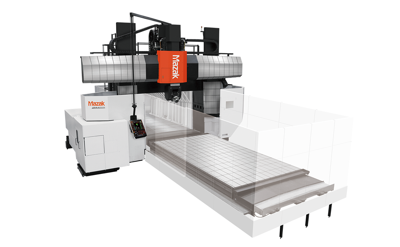

Large multi-face, 5-axis double column machining centre
  • The specialised head for 5-axis machining enables accurate multi-surface machining without the need of a head changer
  • Three types of spindles can be selected according to the machining application.
  • High-speed, X-, Y- and Z-axis feedrate: 30 m/min
VERSATECH image
Improve productivity for large workpiece machining by reducing non-cutting time and process integration
Machining table size up to 10 m, with turning table options for handling various workpieces

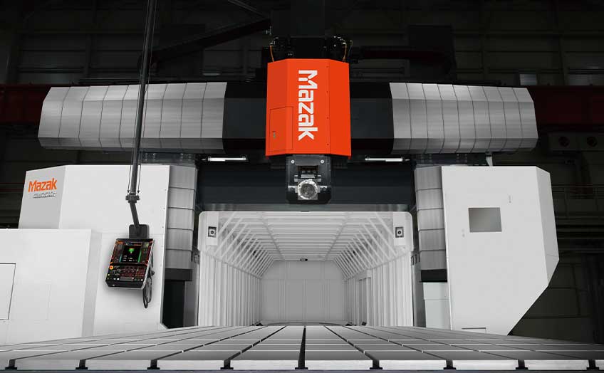

BT50 taper spindle for highly efficient machining
8000 min-1 Spindle (Standard)*
A spindle with an output of 40 kW (40% ED) , maximum revolution of 8000 min -1, and max. torque of 344 N-m, ideal for machining of steel workpieces.
12000 min-1 High-speed spindle (Standard) *
A spindle with an output of 45 kW (40% ED), ideal for processing nonferrous metals such as aluminium.
6000 min-1 High torque spindle (Option)
Spindle with a max. torque of 1218 N-m (15% ED) is optionally available for heavy-duty machining.
