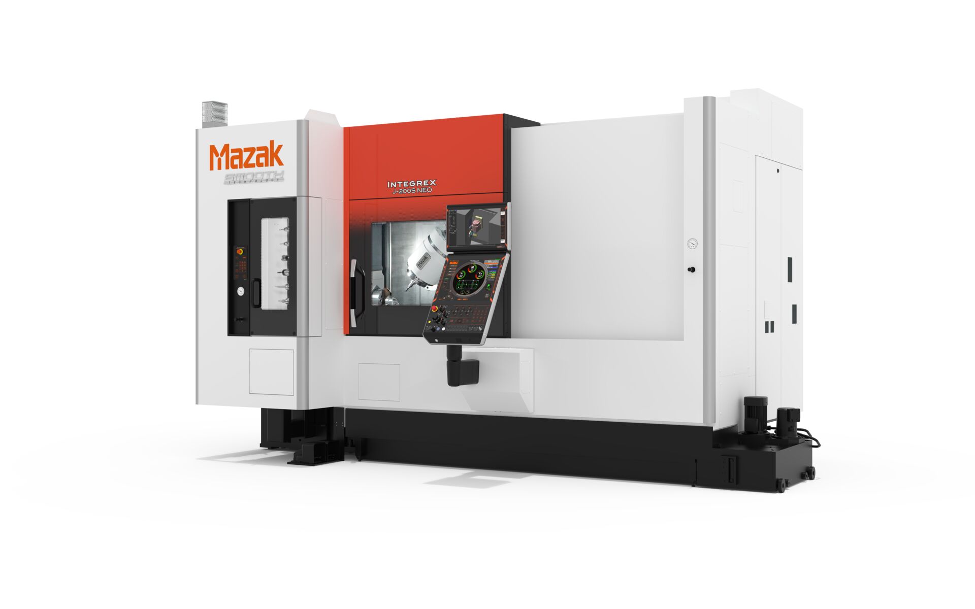

Exhibited for the first time in the UK at Southern Manufacturing will be the brand new INTEGREX j-200 NEO. This is the first INTEGREX model to be manufactured outside Japan with production now commencing at Mazak’s European Manufacturing Plant in Worcester.
Ideally suited to high mix / low volume manufacturing, Mazak’s new INTEGREX j-200 NEO offers a productivity upgrade for turreted lathe users looking to move beyond turning to integrated milling, drilling, and multi-faced machining operations.
INTEGREX j-200 NEO Multi-Tasking machine
Alongside the INTEGREX j-200S NEO second spindle variant, it builds on the success of the original Mazak j-Series models first launched in 2010. The INTEGREX j-200 NEO now offers 0.0001° indexing resolution on the B-axis as standard, enhancing the machine’s capabilities to produce precise angled features.
The INTEGREX j-200 NEO also features a new, compact milling spindle which uses a built-in Mazak spindle motor with increased power (18.5 kW) and torque (59.7 Nm) enabling it to support a broad range of materials and applications. Its compact nature also reduces workpiece interference while increasing the working envelope of the machine.
The main turning spindle, fitted with an 8” chuck, features a powerful 18.5 kW, 326 Nm built-in motor, with an integrated cooling circuit in the headstock, to deliver high material removal rates whilst achieving stable machining accuracy. With a Ø65 mm bar capacity and a Ø480 mm maximum swing, the machine can be easily configured for both automated bar work and robot-fed components.
The machine is available in 1000 U bed length while the tailstock variant is available in 500 U bed length to deliver maximum return on investment from a minimal footprint.

The machine benefits from a 36-tool magazine – with an option of increasing to 72 tools – which significantly reduces setups while offering three times the tool capacity of a turreted lathe, in addition to significantly lower tooling costs compared to driven-tool holders.
