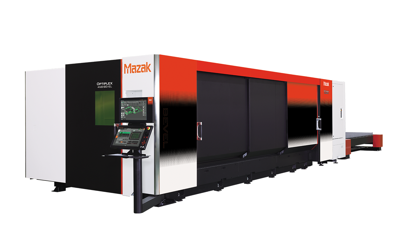

OPTIPLEX 4020 BEVEL
Fiber laser processing machine with bevel cutting

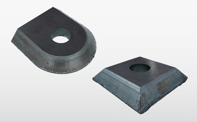

  • Laser processing with process integration of 2D cutting and bevel cutting done by a single machine, achieving reduced material handling and setup time and improved workpiece positioning accuracy for after process such as welding and assembly
  • Various bevel cutting type capability to match your production requirements, including V, Y, X, and K
  • Equipped with Mazak SmoothCUT 20kW laser oscillator
  • Equipped with SmoothBEVEL control, the CNC system for advanced bevel cutting.
  • Fully enclosed cutting area for reduced noise and dust

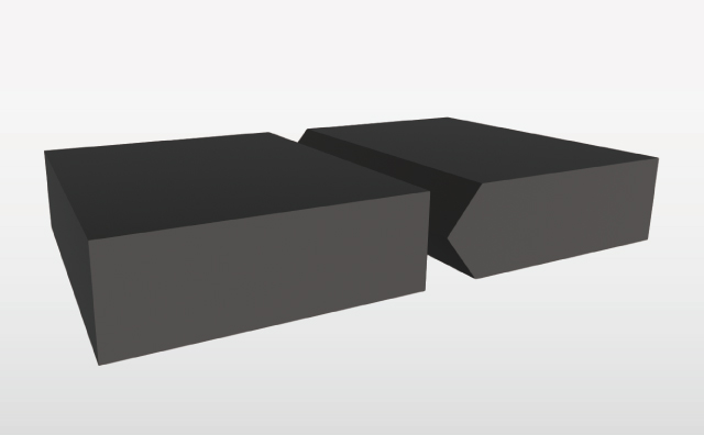

Various bevel cutting such as V-, Y-, X-, and K-type to match your production requirements.
Bevel cutting capabilities enable optimal laser processing according to the application of the materials and welding conditions, allow for the processing of complex products, and create the potential for new business opportunities.

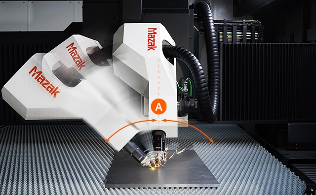

A: ±45°

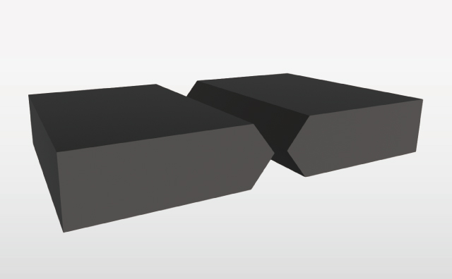

Available bevel processing type

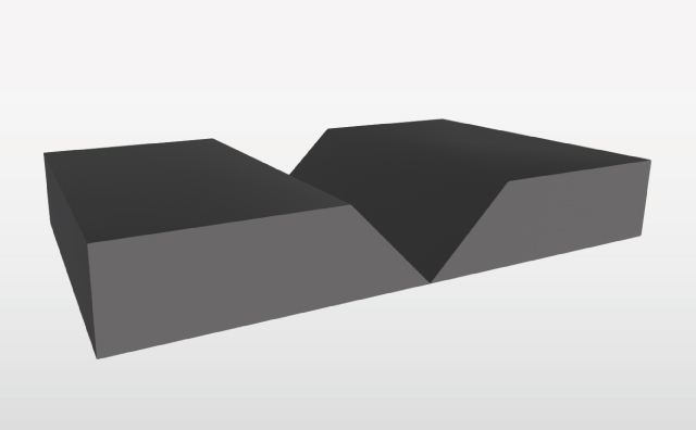

V type bevel cutting

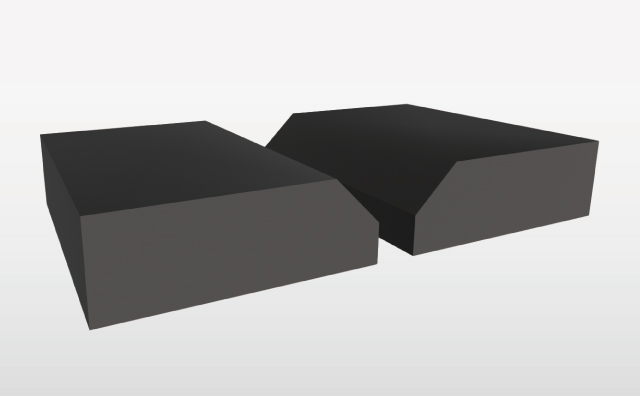

Y type bevel cutting
X type bevel cutting
K type bevel cutting

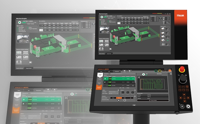

CNC system for laser processing machines with bevel cutting
SmoothBEVEL
  • From programming creation to nesting optimisation, the processes including bevel cutting are all managed on the CNC.
  • The 21.5″ widescreen, flat screen design and pictograms allow for intuitive operation.
  • Simple CAD/CAM functions are available on SmoothBEVEL control, which allow for drawing, importing, bevel assignment, and simple nesting.
