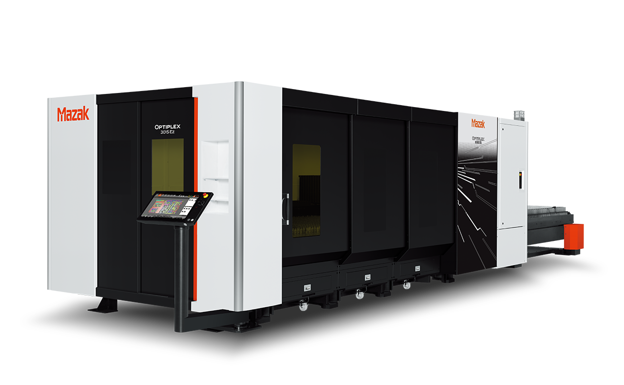

OPTIPLEX Ez
Entry-Level 2D laser processing machine combining cutting performance and ease of maintenance.
Designed to provide high-cutting performance for thin to medium material thicknesses and ease of maintenance. The Ez series the ideal solution for those taking their first step in the laser machining world.

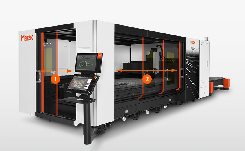

Equipped with Large Front and Side Access Doors
Sliding doors are installed on the front and side of the machine, minimising the floor space requirement. Dimensions of OPTIPLEX 3015 Ez openings are 1200 mm (front) and 3210 mm (side) and OPTIPLEX 4220 Ez openings are 1190 mm (front) and 3130 mm (side). Additionally, slide door on the side of OPTIPLEX 4220 Ez can be opened from both left and right, which makes it easier for the operator to load and unload workpieces.
