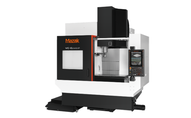

Vertical Machining Centres
VC-Ez IP
Made in India: High-performance vertical machining centres
  • Powerful, high-torque spindle for higher productivity
  • Largest table and machining area in its class
  • Designed for stable, high-accuracy machining
  • MAZATROL SmoothEz: CNC system for unsurpassed usability and high-productivity
Spindle output: 18.5 kW / 7.5 kW (5 min. rating / Cont. rating)
BT40, 12000 min-1 Spindle
Suitable for the powerful cutting of steel materials and machining that use small-diameter materials such as aluminium workpieces. Machining hours can be reduced and excellent finished surfaces can be achieved even with high-speed machining. The spindle is equipped with a ceramic ball bearing which is lightweight and has low thermal expansion, so high-precision machining with low heat generation is possible.
Reliable high-speed ATC and tool magazine
The tool magazine can store 24 tools for machining a variety of workpieces. 30 tool magazine is also an option (standard tool capacity for VC-Ez 660 IP is 30 tools)
Tool change time
(chip-to-chip)
Max. tool length
(From gauge line)
Max. tool diameter
(With adjacent tool)
Max. tool diameter
(No adjacent tool)
Max. tool weight
3.8 sec.350 mmΦ80 mmΦ150 mm8 kg
The table of the VC-Ez IP series has the largest machining area in its class and can load large fixtures and workpieces.
 Table sizeMax. workpiece size.
VC-Ez 410 IP950 mm × 410 mm950 mm × 410 mm × 450 mm
VC-Ez 510 IP1250 mm × 492 mm1250 mm × 492 mm × 570 mm
VC-Ez 660 IP1400 mm × 610 mm1400 mm × 610 mm × 570 mm
Linear roller guides
A high-speed, rigid linear roller guide is utilised on all axes. It provides improved positioning accuracy with lower friction for the long term.
Ball screw core cooling (Option)
Temperature controlled cooling oil circulates through the ball screw cores to ensure stable machining accuracy over extended periods of high speed operation
Coolant / Cabinet cooler / Chip disposal
Flood coolant
Coolant through spindle system (Option)
Cabinet cooler (Option)
Spiral conveyor: horizontal left (Option)
MAZATROL SmoothEz
Equipped with "QUICK MAZATROL", an improved version of MAZATROL programming. Programs can be made intuitively with the 15" touch screen while checking the workpiece shape and work process. If combined with the SmoothCAM Ai software (separately sold), machines in your factory can be replicated on your office PC, allowing digital setup of your machine to improve operational efficiency.
