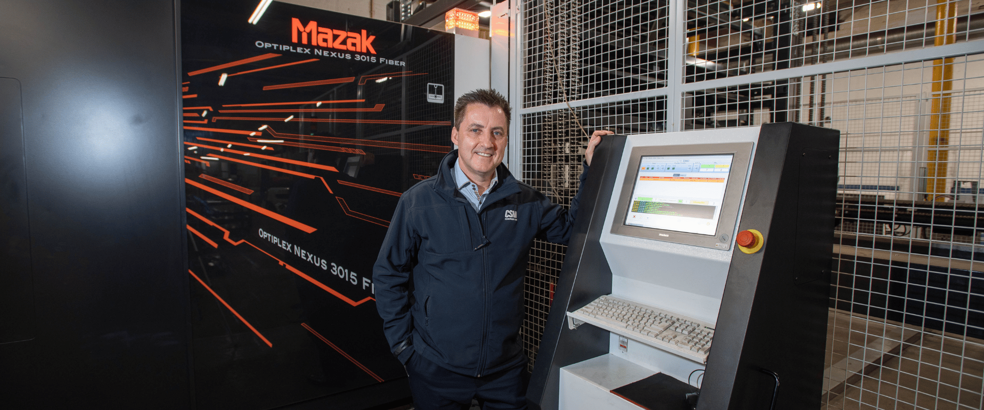

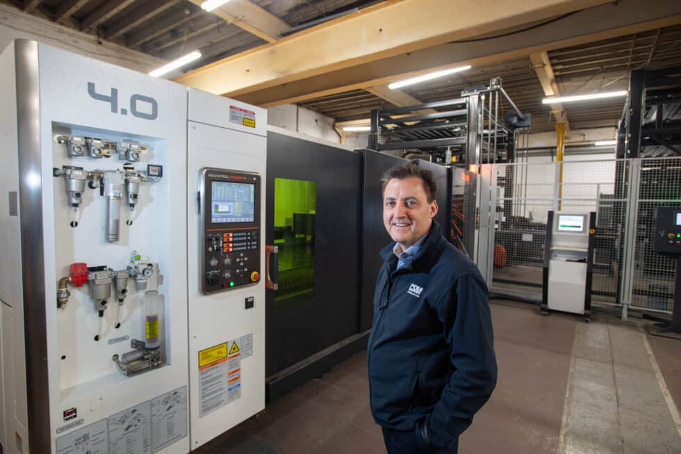

Requiring a solution that would meet CSM’s footprint, technology, and capacity demands, Paul King contacted Yamazaki Mazak to see what it could offer. Mazak suggested an OPTIPLEX NEXUS FIBER 4 kW laser machine with bespoke 10-shelf automation towers. “What really won me over was that Mazak’s technical team was very accommodating, providing constant dialogue and feedback whilst configuring the system’s layout. They were able to make it fit my space and, more than anything, they didn’t compromise on the efficiencies I was getting with the existing machines.”
The automation system arrived soon after the fiber laser processing machine, replacing the previous 18-year-old model. The automation featured a bespoke design, taking into account the pillars and limited tower space available at Swansea Mill, whilst allowing easy access for loading sheets.
Impressive Capabilities
Paul King has been particularly impressed by the speed and the power of the OPTIPLEX NEXUS FIBER, from the very start of the project all the way to post-installation. “Before choosing the OPTIPLEX NEXUS FIBER, Mazak showed me some time studies on a given set of components. Right then, I realised that, despite being the same power, the fiber laser was running twice as quick as my CO2 machine and nearly seven times quicker than my other older laser. Everything up to 4 mm is now being processed on the Mazak because of its efficiency but we are, on occasion, even cutting thicker material up to 12 mm.”
Complementing the speed and power of the OPTIPLEX NEXUS FIBER is the new multi-draw system, which has transformed CSM’s automation capability. “I would load up my previous machine on a Friday afternoon with a big stack of 5-mm and 6-mm material and it would still be running on Monday morning but with the replacement technology, the capacity is less than a day,” Paul says. “The automation has given us an incredible capacity and the machine seems to crunch through any amount of work. I can’t physically feed it enough.”
