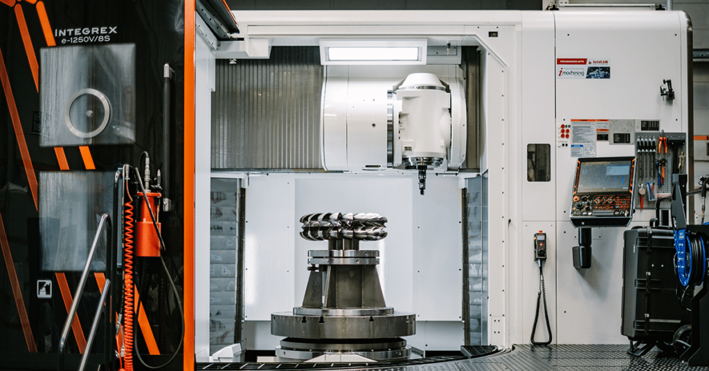

Following the completion of the tender process, Gilkes ordered an INTEGREX e-1250V/8S vertical Multi-Tasking machine, which was delivered and commissioned in early March 2020.
The INTEGREX e-1250V/8S is one of the largest machines in the Mazak range, designed for the 5-axis machining of complex large workpieces. The Multi-Tasking machine is capable of performing a variety of tasks that would normally be completed by multiple machines, including milling, turning, boring, and drilling operations.
Rebecca continues: “We built a close relationship with Mazak following the machine installation. Mazak engineers were on site with us nearly every week throughout 2020 and, working alongside our other partners such as Brown & Holmes, ISCAR, SolidCAM, and VERICUT, we were quickly able to tackle any issues we faced. Specifically, we were able to collaboratively overcome the challenge of completely machining the runner without needing to finish off any hard-to-reach elements with subcontract spark erosion.”

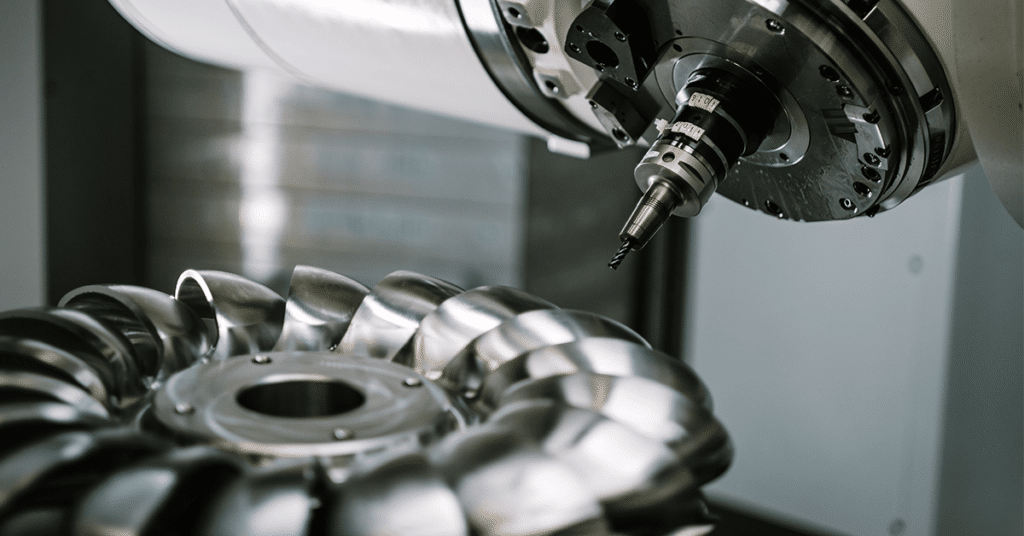

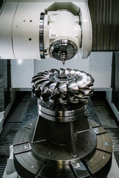

Despite the machine being installed just before the first UK lockdown, the disruption caused by COVID-19 only had a minimal impact on Gilkes. As a result, in December 2020, the team was able to successfully complete Rebecca’s challenge, with the first Pelton runner fully machined on the INTEGREX e-1250V/8S being completed and delivered to a Hydro site.
As well as using the INTEGREX e-1250V/8S for the manufacture of new runners, Gilkes has also benefitted from the flexibility and innovation that comes with owning a Mazak to deliver refurbishment projects in tight timescales. Derek continues: “In the past, when a customer requires a refurbishment, we’ve had to subcontract the work out. This is both very expensive, and unpredictable, as you are at the mercy of a supplier’s production schedules. Now we have the INTEGREX, we’ve been able to design a fixture which allows for single point accuracy fixturing.

“If a customer comes to us with urgent refurbishment, but we’re in the middle of a cycle on another runner, we can pause it, remove the runner, complete the machining, then put the original part back on to the INTEGREX and continue the cycle from within microns of where we left off. That kind of flexibility is invaluable.”
