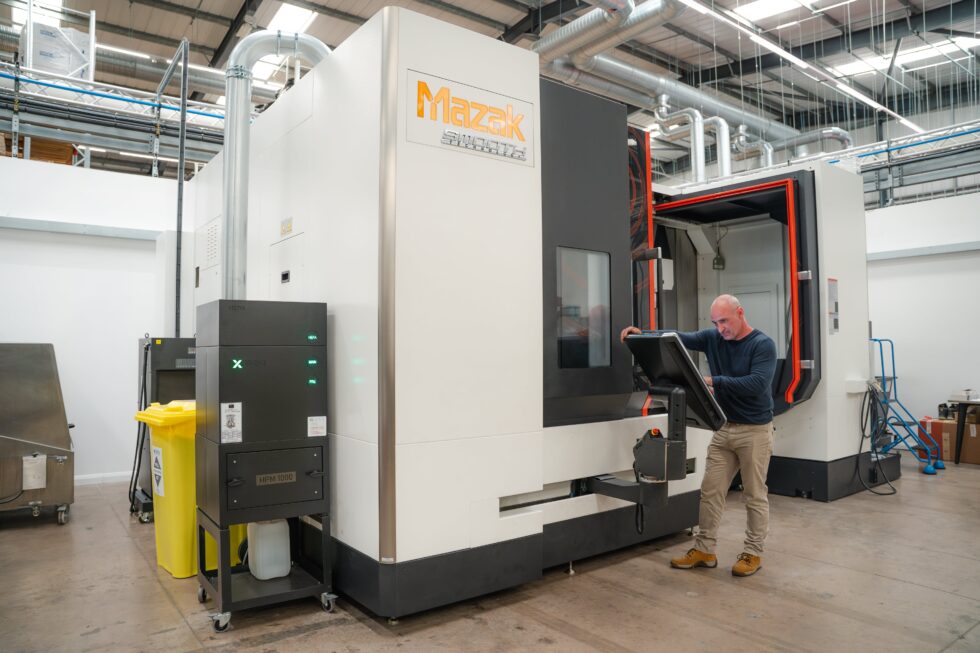

Norton’s commitment to only using the highest quality equipment led them to Yamazaki Mazak. “We looked at various options, but we wanted to be seen to be investing in the best available machine,” says Adam. “Mazak are the kind of people we want to be doing business with.”
Norton specified a VTC-800/30SLR, manufactured in nearby Worcester, which has a high capacity working area and a wide door opening making it ideal for larger workpieces, such as motorbike frames.
“The size of the frame meant we needed a big machine, but also one that could work to very high tolerances. It’s all about repeatability. The machine takes away manual process. Now every single dimension will be within 0.2 mm of each other. We’ve tightened tolerances up by 80% whereas previously there was 6 mm of difference at times from one frame to another.”
Adam continues: “The shopfloor is my customer. We can measure everything to microns in temperature-controlled facilities. Nothing is going to assembly now unless it is right. I have to give them a good pass to ensure they can meet their goals. Now, when the shopfloor receives a frame, the repeatability is going to be much better.”

“The core purpose remains frame machining, but we have been able to also introduce detail parts onto the machine as well, such as swing arms that are billeted from aluminium. The VTC is more than capable.”
