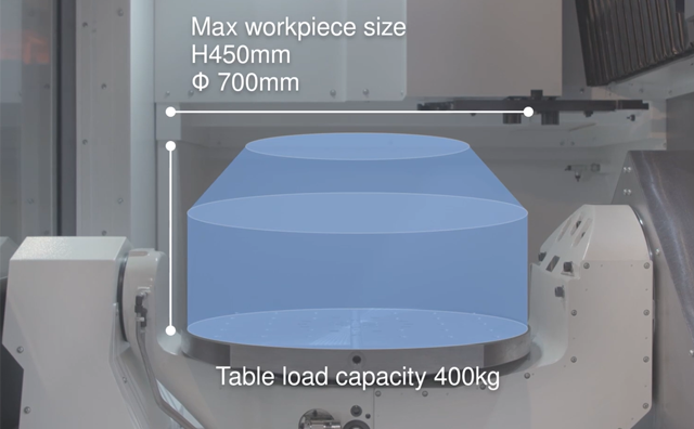

Max. Workpiece Size
Φ500 mm × 320 mm
Φ700 mm × 450 mm
Max. Table Load
200 kg
400 kg

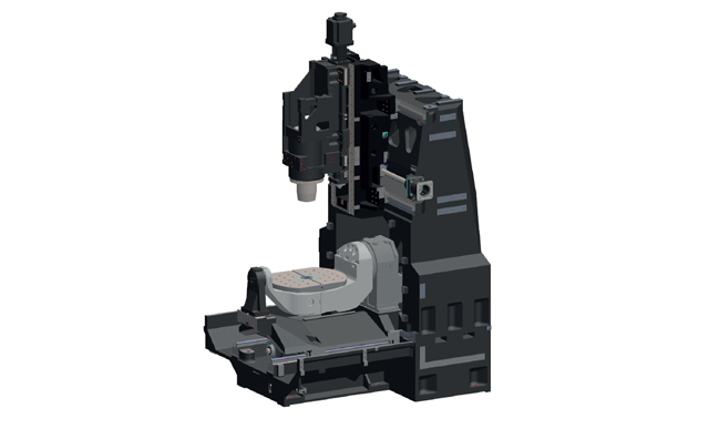

Bridge-style construction & zero-backlash trunnion technology
  • Bridge-style construction 5-axis vertical machining centre with a fully supported trunnion table provides high-rigidity for high-accuracy machining.
  • The unique rolling motion of the rotary B- and C-axes delivers enhanced torque whilst also eliminating backlash, resulting in high-performance and high-accuracy machining.

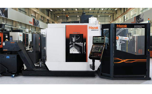

Every CV5 machine is built to support modern manufacturing agility. Featuring an independent side-loading access door, the CV5 integrates directly with automation modules like the Mill-Assist (MA) or flexible pallet system, such as the CP-450. This leaves the primary front door completely unhindered, allowing operators to make fast manual interventions and run small batches without disrupting the automated handling cell.

Yes, this is one of its key advantages. Even when the machine is integrated with our automation systems, there is still excellent operator accessibility. Having the option to adopt automation at a pace that suits our customers needs was always at the forefront of the design process.
We have several different automation systems to suit different manufacturing needs. Whether that’s our new CP-450 pallet pool system (unmanned running), Mazak Mill Assist Systems (robotic part loading and unloading) or third-party automation. You can start with a standalone machine and build in the automation as and when production volume increases to protect your investment.
