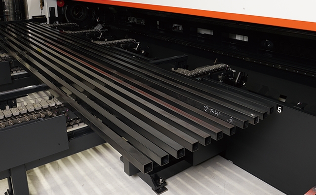

Automatic loading of materials and unloading of finished parts
The standard model can load and unload materials and finished parts up to 8 m. Optional 6 m, 12 m and 15 m loading / unloading units are available.
1: Load long tubes, pipes and structural materials
2: Unload finished parts and offcuts automatically

Chain type conveyor
Easily load larger quantities of material (depends on diameter) for continuous operation.
(Example of max. quantity of material diameter: Φ20 mm × 40, Φ400 mm × 5)
