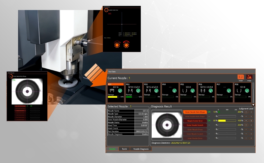

Automatic Nozzle Diagnosis / Automatic Beam Centering(option)
Automatic nozzle diagnosis automatically detects the condition of the nozzle and the deviation of the nozzle centre position from images captured by the nozzle diagnosis camera. If any damage to the nozzle is detected, it is automatically replaced with another nozzle. If the nozzle centre position is misaligned, it is automatically adjusted using the automatic beam centring. Automatic diagnosis and adjustment improve productivity and processing accuracy during automatic operations.
Display a diagnostic result on the CNC screen
