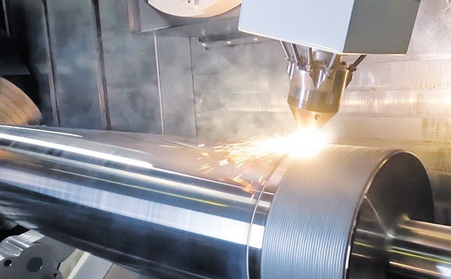

Laser metal deposition

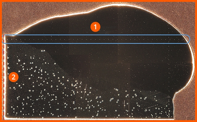

Laser metal deposition technology is a manufacturing method that instantly melts and solidifies metal powder using a laser. It enables high-precision and dense forming, making it suitable for complex shapes, thin walls, and fine structures. Furthermore, it can form corrosion-resistant, wear-resistant, and heat-resistant layers with sub-millimeter thickness on the base material surface, achieving higher adhesion compared to plating or thermal spraying. It is an advanced technology that can be used to fill only the necessary parts and is effective for repairs and modifications.
1: Deposited zone 2: Dilution zone 3: Laser 4: Metal powder 5: Melt pool

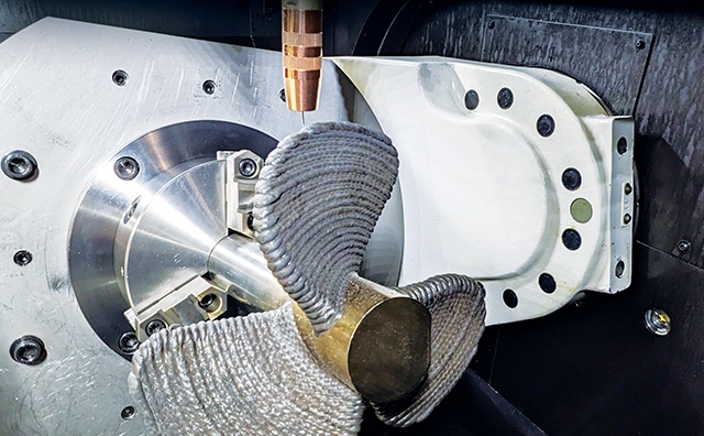

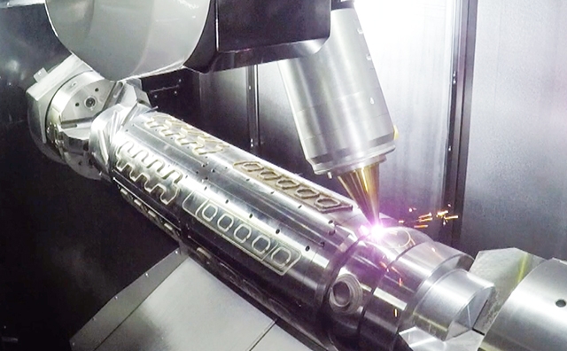

Wire arc AM
Wire-arc AM technology is a fabrication method that melts and deposits metal wire through arc discharge. Compared to powder, it is easier to handle and enables stable supply at low cost. Its high fabrication speed makes it ideal for producing large parts and performing build-up repairs. Hybrid multi-tasking machines enable machining during the layering process, allowing the shape of each layer to be refined as the build progresses. This process removes impurities and irregularities from the layered surface, significantly improving manufacturing precision. Ultimately, this results in more faithful shape reproduction and high-quality internal properties. Compared to laser metal deposition, it offers superior productivity and cost-effectiveness, making it widely used for manufacturing large components in aircraft and industrial machinery.
1: Metal wire 2: Deposited zone 3: Dilution zone 4: Assist gas 5: Arc 6: Melt pool

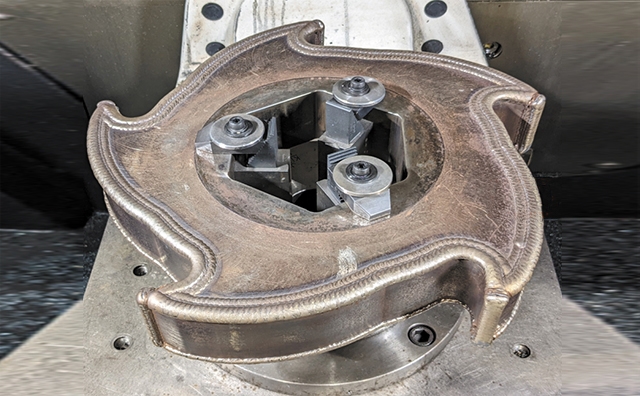

3D additive manufacturing
Direct additive manufacturing allows for optimized structures, such as hollow shapes and topologies, which are difficult to achieve with conventional machining or casting processes. This enables new design concepts through weight reduction and functional integration.

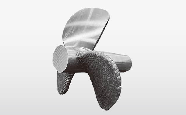

Marine propeller

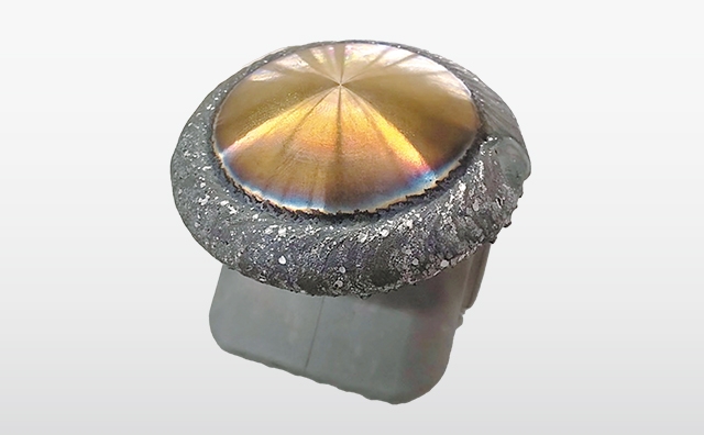

Roll die cutter (Blade)

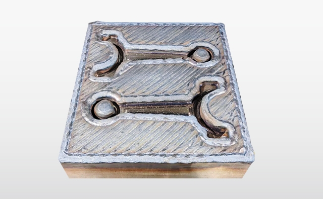

Forging mold

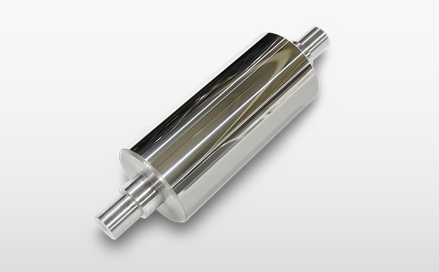

A coating that increases hardness and wear abrasion
By layering high-hardness alloys or wear-abrasion materials on the surface of the base material, the lifespan of parts can be significantly extended. This is effective for parts used in harsh environments, such as tools and molds. By controlling the laser beam diameter, it is possible to adjust the coating thickness and processing speed.

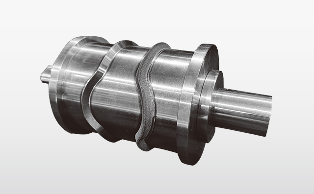

Coupling
Industrial rolls

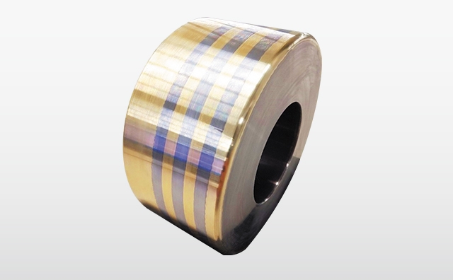

Layered deposition of dissimilar metals
By layering different metal materials, multiple properties such as wear resistance and corrosion resistance can be imparted, dramatically increasing design freedom and allowing the creation of composite material parts that were not possible with conventional methods.

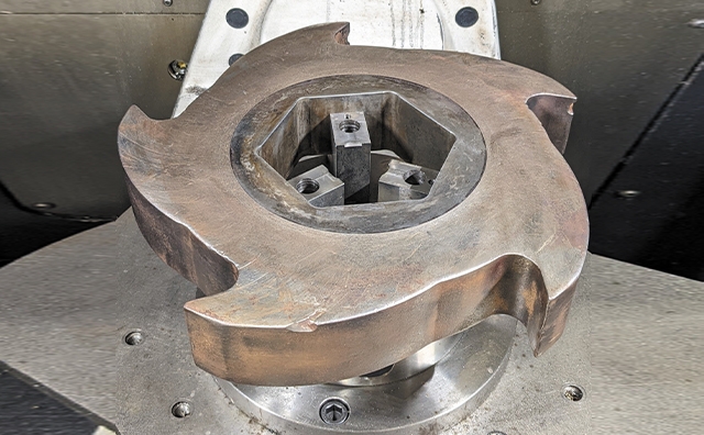

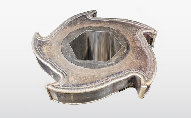

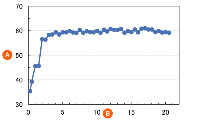

Repairing parts by wire arc AM
It solves challenges in manual repair (build-up welding, finishing) such as lengthy operations, quality inconsistencies, and frequent setup changes between machining processes. It achieves repair automation as a solution to labor shortages and technology inheritance.
WorkpieceCrushing blade of the crusher
IndustryGeneral machinery
MaterialWear-abrasion steel
Workpiece sizeΦ500 mm × 80 mm
Hardness (equivalent to HRC60)
A: HRC
B: Distance from the end face of the test specimen (mm)
