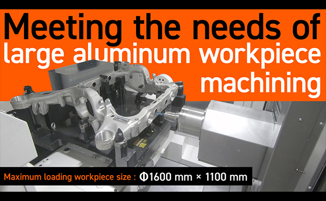

Meeting the needs of large aluminum workpiece machining
The rise of electric vehicles against a backdrop of strengthening environmental regulations has led to an increased need for machining large aluminum workpieces to form integral vehicle parts. The FF-1250H has a machine structure specialized for process integration, contributing to shortening production lead times and increasing productivity in the machining of large aluminum workpieces.

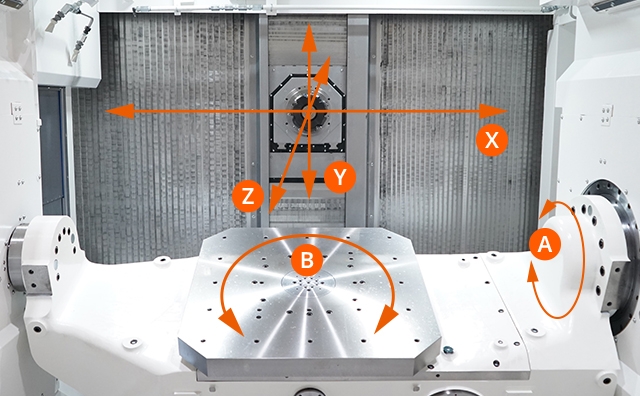

Large 2-axis table for machining large workpieces
2-axis rotary table
The tilting rotary table, which has two rotary axis (A- and B-axis), can change the workpiece orientation freely, enabling multi-surface continuous machining without setup changes.

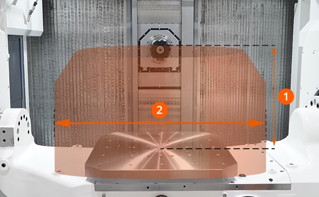

Table size capable of loading large workpieces
The large 2-axis table has a high rigidity due to the base structure with support on both ends.
Maximum loading workpiece size:
Φ1600 mm × 1100 mm, 650 kg
