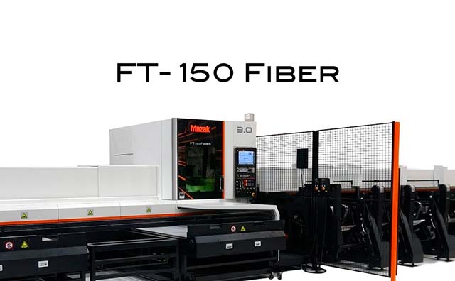

FT-150 FIBER
- U-axis control provides high-speed, high-accuracy cutting
- The productivity of pipe mass production operation is automated and significantly improved
- Optional drilling and tapping can be performed by just one machine
- Reduced running costs with energy-efficient fiber laser
- New graphical user interface (GUI) of the CNC system greatly improves operability

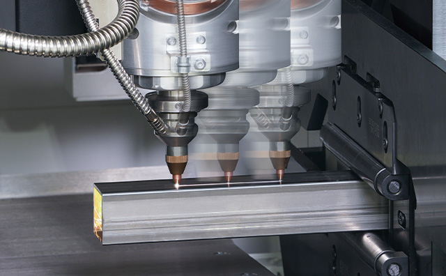

Cutting of a variety of sizes and materials. High-speed, high-accuracy cutting by U-axis control
The FT-150 FIBER is capable of processing round pipes with a maximum diameter of Φ152 mm and square pipes with a size of 125 mm per side. The laser head can be operated at high speed by U-axis and can cut materials such as mild steel, stainless steel, copper, brass, and aluminum with high speed and high-accuracy.

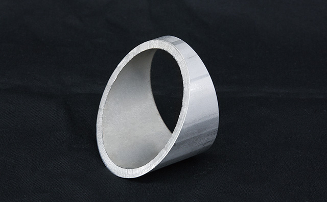

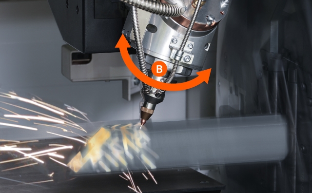

B-axis for bevel cutting as standard
The laser head with B-axis can cut materials at desired angle This ensures high-accuracy bevel cutting and improves the quality and strength of the joint.

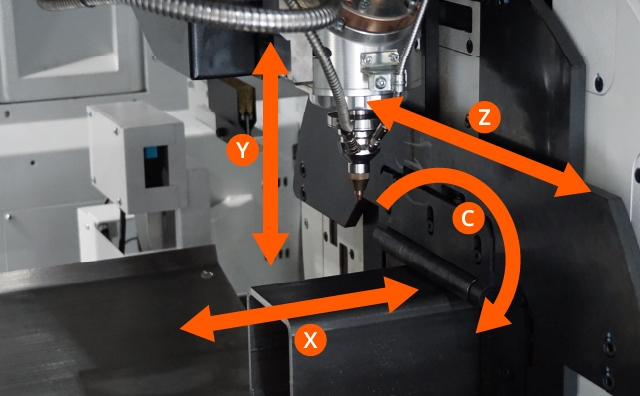

High-speed feedrate and chuck indexing speed
| FT-150 FIBER | |
| X-axis | 150 m/min |
| Y-axis | 65 m/min |
| Z- axis | 65 m/min |
| C-axis | 54000 deg/min |

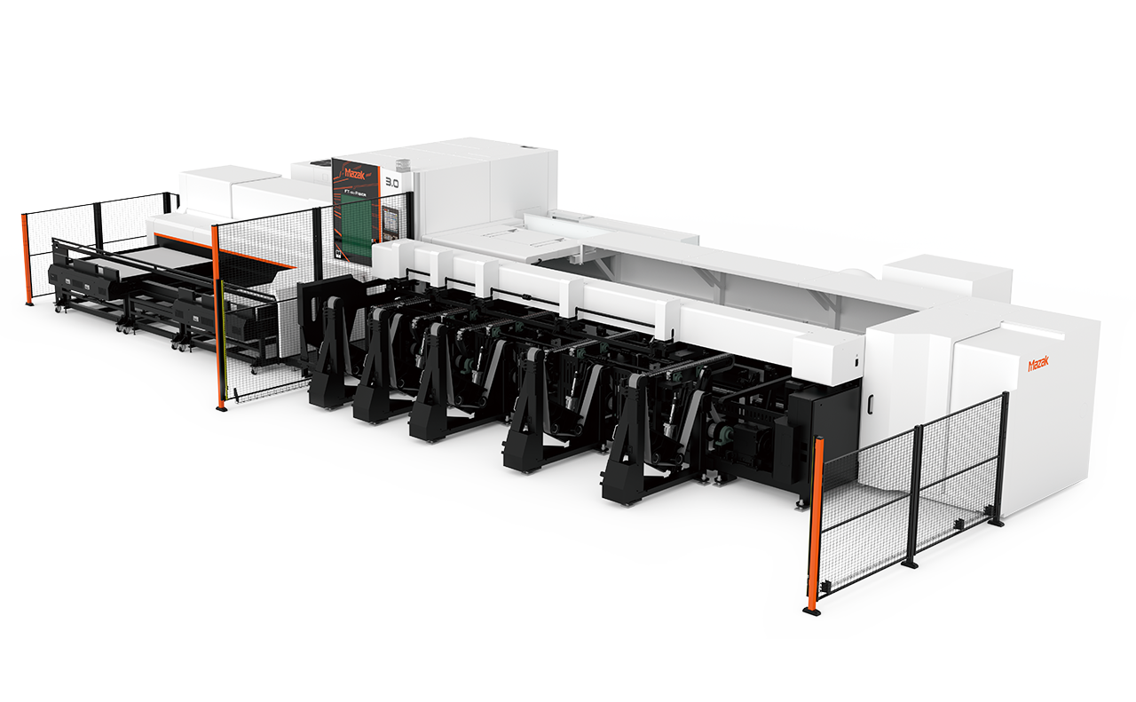

Large-capacity bundle loader for continuous operation
Materials are automatically loaded into a high-capacity bundle loader, and after laser processing, the cut parts are automatically unloaded.
Structural steel and sudden interruption workpieces can be loaded manually.
Designed for high efficiency
The loading and unloading of material is performed at the front of the machine to minimize operator movement.

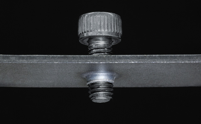

Thermal Drilling
Tapping on thin plates can be performed with the optional thermal drilling function.
