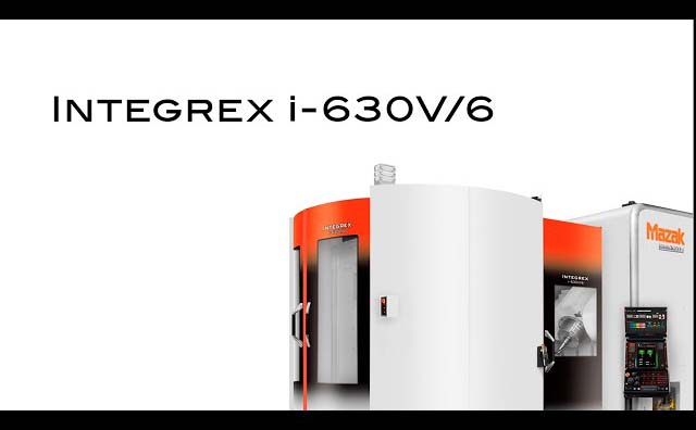

INTEGREX i-630V/6
| Tool shank | BT50 |
| Max. workpiece size | Φ1050 mm × 1000 mm |
| Max. spindle speed | 550 min-1 (rpm) |

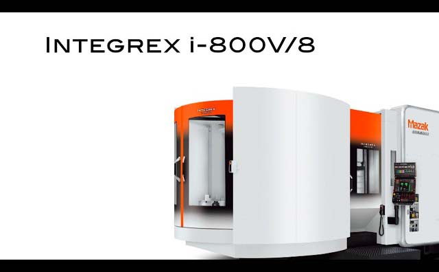

INTEGREX i-800V/8
| Tool shank | BT50 |
| Max. workpiece size | Φ1500 mm × 1500 mm |
| Max. spindle speed | 500 min-1 (rpm) |
