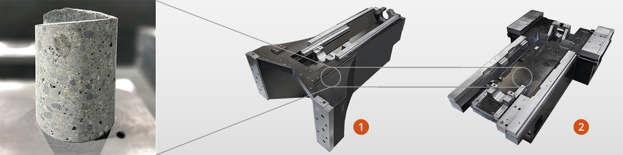

  • Mineral casting with excellent vibration damping is used for the base and column
VCN-460 HDCC
Mineral casting composite used for the main structure
Excellent thermal stability
Because it does not easily transmit heat, it is resistant to high temperature and temperature changes, improving machining precision and machine operation rates.
High vibration damping
It has excellent vibration damping properties, quickly absorbing external or machine-generated vibrations to improve machining accuracy.
Longer tool life
By absorbing vibrations during machine operation, the impact on tools is minimized, contributing to longer tool life.
1: Column 2: Base
About mineral casting
Mineral casting is a high-performance composite material made by bonding minerals with epoxy resin, which has high vibration damping properties and thermal stability, contributing to the high efficiency and high precision of machine tool. In addition, since high-temperature melting is not required, energy consumption during manufacturing is reduced by more than 50% compared to normal casting. By reducing CO2 emissions, it can contribute in reducing environmental impact .

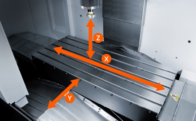

Large machining area and table size
The table of VCN-460 HDCC has a large Y-axis stroke to ensure a large machining area. Large fixtures and workpieces can be mounted.
Y-axis strokeTable sizeMax. workpiece size
460 mm900 mm × 460 mm900 mm × 460 mm × 570 mm
