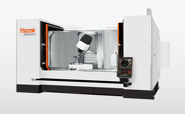

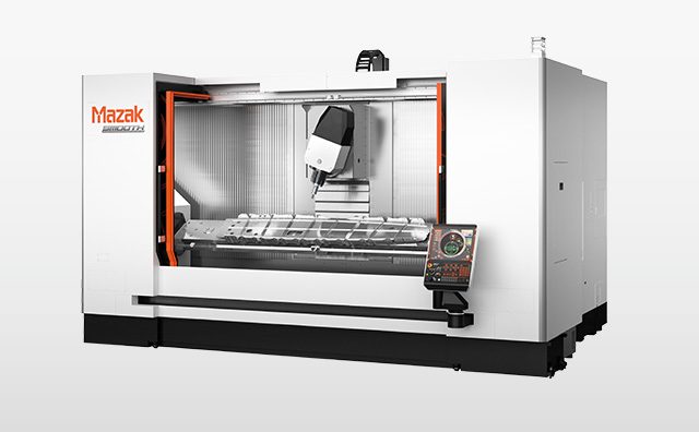

5-axis Machining Centers
VTC-800/30
- Machining of complex workpiece contours by simultaneous 5-axis machining*1
- Machining at any angle of vertical, horizontal, and slanted surfaces with ±110° B-axis swiveling head, increasing productivity through process integration.
- 3500 mm × 820 mm long table allows machining of long workpieces, multiple pieces, and can be used as a 2-pallet changer.*2

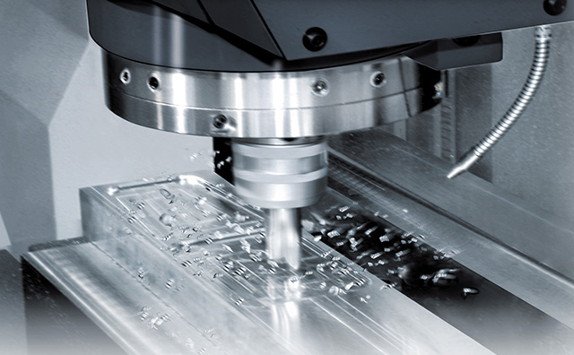

- 18000 min -1 high output spindle for machining a variety of materials from aluminum to steel
*1: VTC-800/30SR requires optional NC rotary table.
*2: Optional fixed table for VTC-800/30SDR has different dimensions.

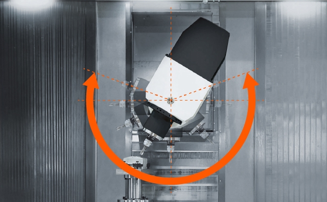

Swivel axis enables various machining
B-axis swiveling head with a swivel range of 220° performs indexing at 0.0001° increments with a zero backlash roller gear cam and servo motor.
Index coupling can be clamped every 5° increments and are suitable for heavy duty cutting.
In addition, any angle of vertical, horizontal, and slanted surfaces can be machined, improving productivity through process integration.

The VTC-800/30 series has a 18000 min-1, 35 kW (47 HP) [50% ED] high output spindle.
The spindle can be used to cut various materials, including aluminum, cast iron, and steel.

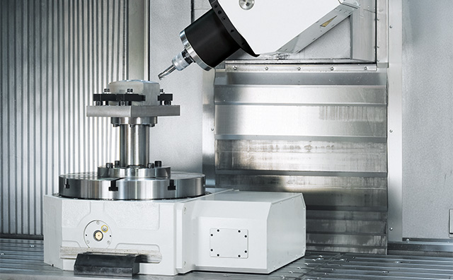

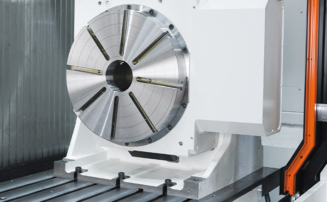

NC rotary table (option)*
Selecting the optional NC rotary table enables simultaneous 5-axis machining.
The rotary table, which can be placed horizontally or vertically, can also be placed on either side of the machine table.
The same roller gear cam as the B-axis allows contour machining.
* Compatible with VTC-800/30SR only

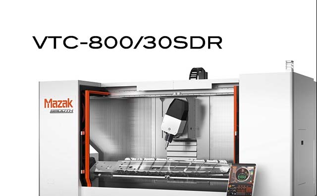

Dual synchronized rotary tables*
Ideal for machining long 5-axis workpieces such as air craft parts
The VTC-800/30SDR has a dual synchronized rotary tables and, by eliminating the fixed table, a highly effective chip disposal.
This is an ideal solution for machining aerospace components which require high-accuracy simultaneous 5-axis machining and high material removal rates.

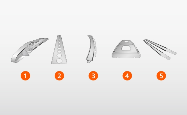

Applications

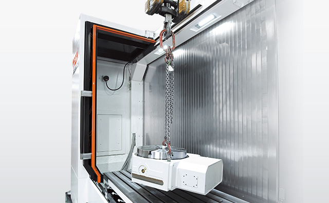

Ergonomic design for convenient operation

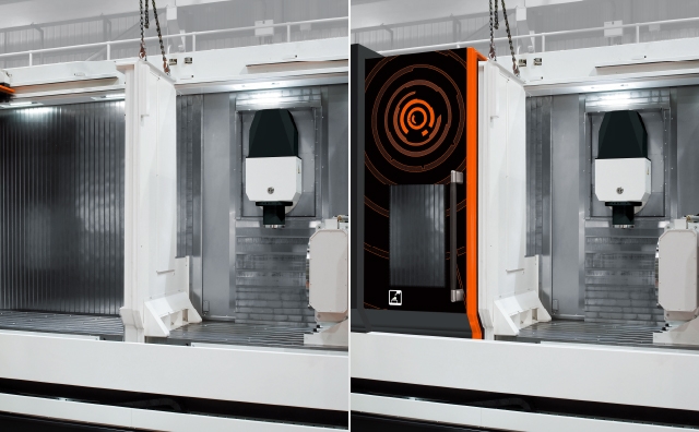

Excellent table access
The door is sashless, without any beams in the ceiling area. There is no interference when using an overhead crane for fixture setup and loading/unloading of large workpieces.

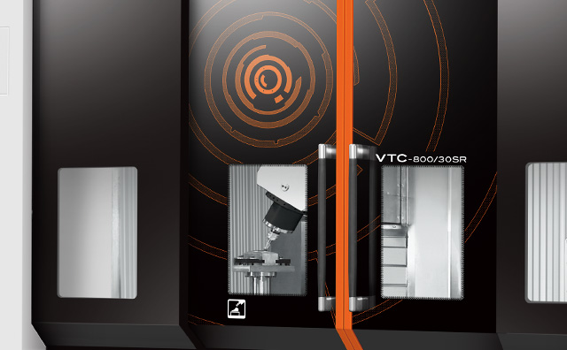

Large windows
The large front door windows as standard allow the operator to easily monitor the machining process.
Accessibility
The operator door provides excellent accessibility to the table, making setup easier.
