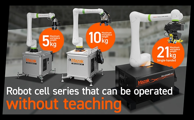

Ez LOADER
Machining center Turning center Workpiece transport type
Compact automation system for
collaborative robots
  • Includes a robot arm, a vision sensor, and dedicated software
  • Compatible with Mazak’s small and medium-sized multi-tasking machine, CNC turning centers, and vertical machining centers
  • Utilizing collaborative robots to create a safe and compact system
Ez LOADER 10
Maximum work weight : 5 kg
Ez LOADER 20
Maximum work weight : 10 kg
Ez LOADER 30
Maximum workpiece weight: 21 kg*
* Single-handed

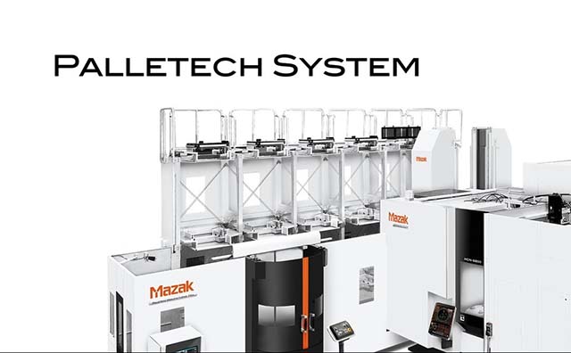

PALLETECH
Machining center Pallet transport type
Automated pallet transfer system
The PALLETECH system improves productivity by making effective use of machines and fixtures with minimal capital investment and by improving system uptime.
  • Automatic transport of pallet with fixture and workpieces
  • Reduced idle time of machines and fixtures identified through system simulation by optimizing machining schedules
  • Highly reliable machines and systems that enable improved system availability
Flexible system expansion
You can choose the optimal size of the "PALLETECH MANUFACTURING CELL" (1-level), "PALLETECH HIGH RISE SYSTEM" (2-level), or " PALLETECH HIGH RISE SYSTEM" (3-level) based on your current production volume and budget. Once installed, it can be expanded as needed to accommodate growing production volumes.
Different types of machine tools can also be incorporated
A horizontal machining center, simultaneous 5- axis machining center, and multi-tasking machine can be integrated into one system.

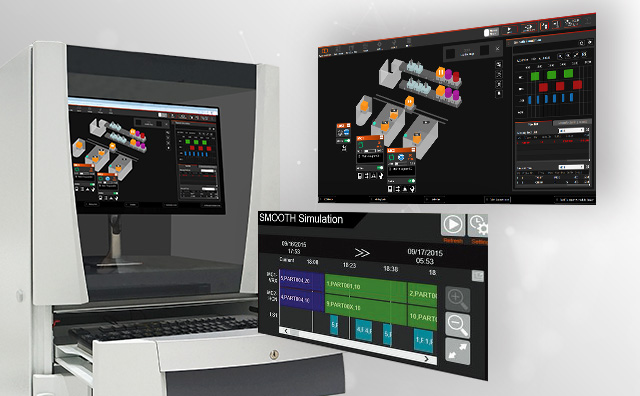

PMC NEO
PMC NEO is software that automatically operates and manages Mazak's flexible manufacturing system "PALLETECH System." With “Smooth simulation”, you can check machining progress and tool resources for up to one month in advance during automatic operation, enabling long-term unmanned operation.
Smooth Simulation
Simulation can be performed for up to one month during automatic operation. Easy tool preparation makes production output easy to predict. It is also possible to level out the machine load.
Scheduling
PMC NEO can be operated according to your production style; schedules based on part numbers that allow for flexible production, or schedules based on simple pallet numbers. It is also possible to operate production that combine multiple part numbers, or complete all the steps one item at a time.
Server PC maintenance
It comes standard with an uninterruptible power supply for unexpected power outages, as well as HDD duplication using RAID. This helps reduce the risk of PC downtime.
Home Screen
The basic screen allows you to see the system status at a glance, and has a similar design with MAZATROL SmoothCNC.
Connectivity
It can also be monitored from an office PC connected via LAN.
Performance tracking
Various performance data is output in a variety of graphs. We have made it easier for administrators to analyze operation.

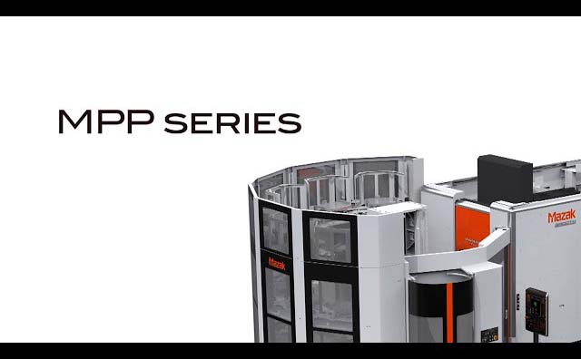

MPP(MULTI PALLET POOL)
Compact multi-level pallet stocker system
MPP (MULTI PALLET POOL) is an automated system that combines 5-axis machining centers or horizontal machining centers with a pallet stocker and a pallet loader. Up to 24* pallets can be applied. This automation system is ideal for small-lot, multi-product production and will dramatically improve productivity.
* Some models are not compatible.
MPP 6PC, 12PC, 18PC type
Minimum floor space requirements
Uses the same production system as Mazak's automation system (PALLETECH system) for reduced floor space.
VARIAXIS i-700 NEO (120-tool magazine)
Left: 2-level 12PC stocker system Right: MPP(12PC)
A: 7587 mm, B: 8946 mm, C: 67.87 m2, D: 4217 mm, E: 8969 mm, F: 37.82 m2
Expandable pallet stocker
6, 12 and 18 pallet storage capacities are available after initial machine installation.
  • * |Only for VARIAXIS i series (excluding i-800NEO), MPP can be installed after delivery of the stand-alone machine. MPP installation preparation (single table) is required.
A: 6PC (3 pallets x 2 levels), B: 12PC (6 pallets x 2 levels), C: 18PC (6 pallets x 3 levels)

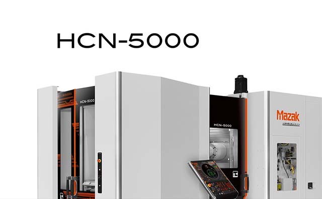

MPP 10PC, 16PC, 24PC type*
  • * |Some models are not compatible with 24PC.
HCN-4000 NEO (120-tool magazine)
Left: 2-level 16PC stocker system Right: MPP(16PC)
A: 7531 mm, B: 7672 mm, C: 57.78 m2, D: 4633 mm, E: 8673 mm, F: 40.18 m2
10 and 16 pallet storage capacities are available after initial machine installation. We also offer models that can apply up to 24 PCs.
  • * |MPP can be installed after delivery of single machines. 2PC or flexible manufacturing system preparation (optional) is required. The number of stockers is different from the standard specification and can be selected from 8 or 14 PC. 24PC cannot be expanded from 10PC and 16PC.
A: 10PC (5 pallets x 2 levels), B: 16PC (8 pallets x 2 levels), C: 24PC (8 pallets x 3 levels)
Transportable workpiece specifications
ModelPallet sizeTransport weight
(Without pallet)
Max. workpiece size [diameter x height]
(Without pallet)
10PC, 16PC
HCN-4000 NEO400 mm × 400 mm400 kgΦ630 mm × 900 mm
HCN-5000 NEO500 mm × 500 mm700 kgΦ800 mm × 1000 mm
HCN-5000/50500 mm × 500 mm 700 kgΦ800 mm × 1000 mm
24PC
HCN-5000 NEO500 mm × 500 mm700 kgΦ800 mm × 700 mm (1st/2nd level)
Φ800 mm × 1000 mm (3rd level)
