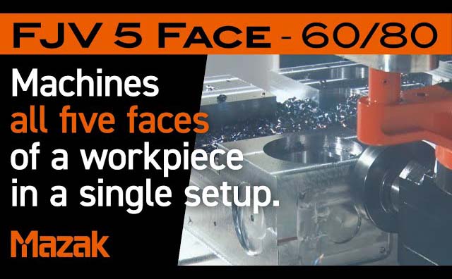

FJV 5 Face
- Units and functions that make 5-surface machining accessible as standard equipment, achieving process integration

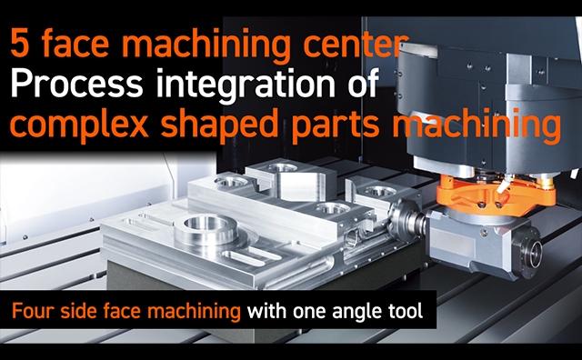

Units and functions that make 5-Face machining accessible as standard equipment
Four side face machining with one angle tool
The MAZAK 5 Face angle head is capable of powerful cutting with its unique hydraulic pressure clamping unit that provides strong fixation.
Wide angle head cutting range
Compact angle head reduces interference with workpiece for large machining area.
Enhanced versatility
The dedicated angle tool magazine has a storage capacity of 8 tools, which makes it possible to handle a wide variety of workpieces.
Simplified programming
The MAZATROL conversational program for 5-surface machining makes it easy to create programs for side face machining.
