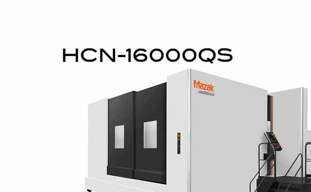

Photo: HCN-16000QS
Maximum workpiece height: 1800 mm

HCN-16000Q
| Pallet size | 1600 mm × 1250 mm |
| Tool shank (standard) | BT50 |
| Max. spindle speed | 3000 min-1 (rpm) |
| Max. workpiece size | Φ3000 mm × 2000 mm |
