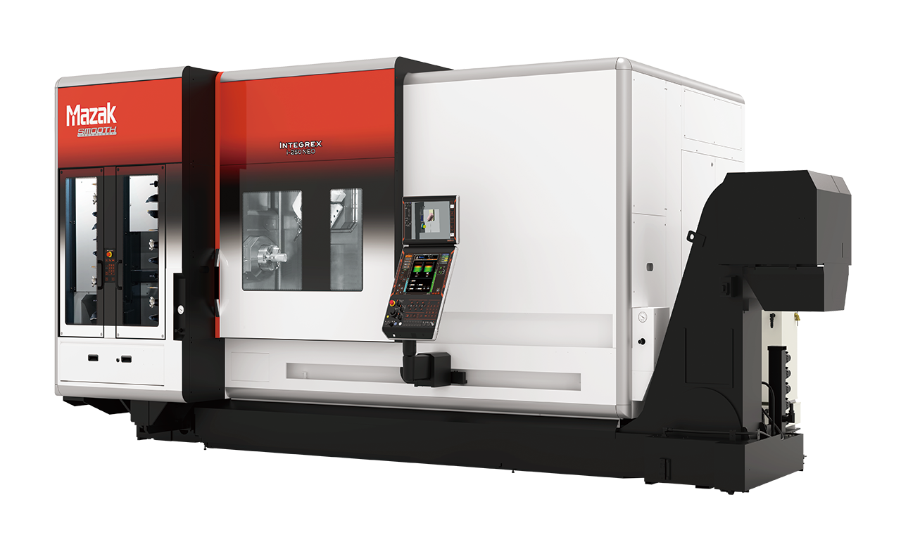

INTEGREX i NEO
- The compact design milling spindle with minimum interference and a variety of the spindle specifications available
- Machining area and Y-axis stroke to expand applicable workpieces size and shape
- Equipped with a high-accuracy built-in motor turning spindle
- A second spindle specification and lower turret specification available for process integration
- Front tool magazine equipped for optimal tool setup for a wide variety of workpieces
Machine construction that achieves high-accuracy and high-productivity
Based on structural analysis, the best machine structure combining turning centers and machining centers was newly designed to achieve stable, high-accuracy machining over the long term. High positioning and machining accuracy are achieved over the entire Y-axis stroke.
