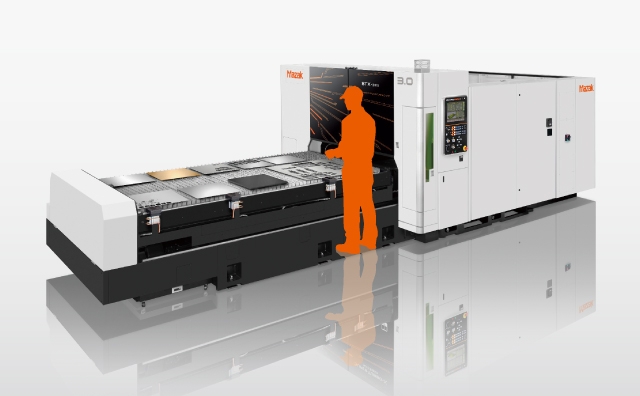

2D fiber laser processing machine with table feed system
  • Equipped with an oscillator for processing thin to medium thickness materials (STX CHAMPION series: 2.0 kW, STX series: 3.0 kW)
  • Table feed system for minimum floor space and excellent table access
  • Various intelligent functions to automate setup work
  • Highly flexible automation system to save manpower
stx3015
Space-saving, easy-to-operate machine design
Significant reduction in floor space
The table feed system of the STX series requires less than half the space of a standard flying optics type laser machine.
stx3015_size Flying optics type (Fixed table type) STX-3015
Excellent table access with the table drive system
The table feed system provides excellent accessibility and allows easy loading of material, not only for regular size worksheets, but also for remnant material, even for a single part. Unloading workpieces is also easy.

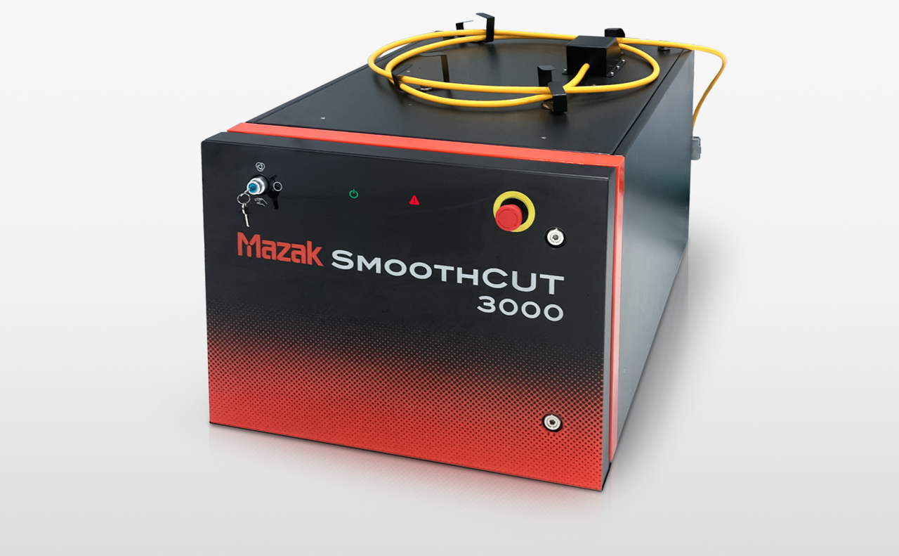

Mazak SmoothCUT laser oscillator
Achieving high-quality and high-productivity
Optimized beam quality and shape for high-speed processing ensure stable cutting of thin to medium thickness materials.

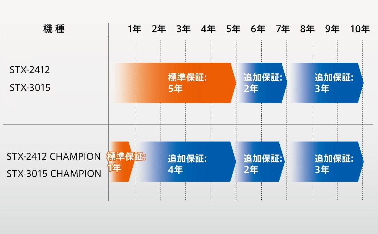

Warranty period
The Mazak SmoothCUT comes with a standard 5-year warranty. For added peace of mind, optional seven‑year and ten‑year warranties are also available.
The STX CHAMPION series comes with a standard warranty period of one year, with optional extended warranties of five, seven, or ten years available.

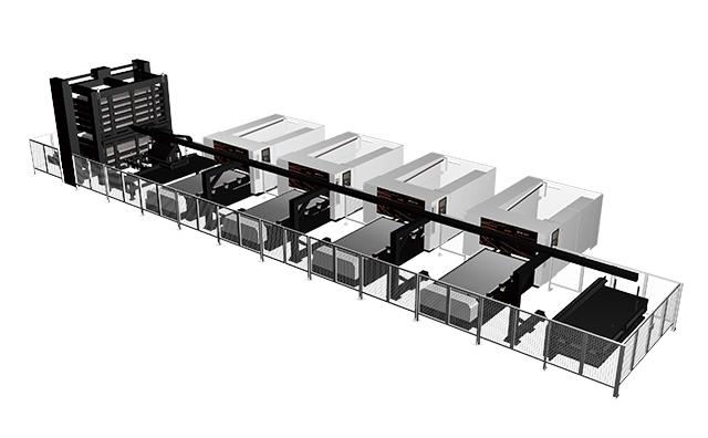

Flexible Mazak Laser FMS
You can add shelves and machines and expand the system after the initial installation.
It can also be connected to your existing Mazak laser processing machine.
The number of machines can be expanded up to four.
stx_automation_01
Higher productivity
Production processes can be managed through schedule operation, enabling progress tracking.
The conveyor system can handle materials with a thickness of 25 mm. It contributes greatly to productivity improvement by reducing loading and unloading time with cranes and by reducing heavy labor by workers.
